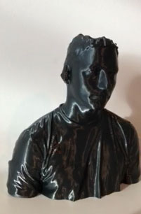

Gail Ray, a mechanical design student at the community college, and former architect, is currently completing her Honors Independent Study classes in additive manufacturing and subtractive manufacturing, with an emphasis in technology in art. As an architect by trade for almost 30 years, Ray is well-versed in both areas of art and technology. She chose this path of study to combine her interest in portraiture, 3D modeling, and printing. As a final project for her additive manufacturing class, she chose to create a 3D life-size sculpture of the upper-body bust of a live person.
Dana Green (from Exact Metrology) as he scans Ketzalli Dondiego (student)
Dana Green, an applications engineer with Exact Metrology since 2014, traveled from his home office in Brookfield, Wisconsin, to Blong Technology Center in Iowa, equipped with the latest scanning equipment: an Artec Eva 3D handheld scanner. The Artec Eva scanner scans fast, capturing and simultaneously processing up to 2 million points per second with up to 0.1 mm accuracy. It employs structured-light technology, and is safe for scanning live models.
Using the 3D scanner, Green was able to scan Ray’s chosen model, fellow mechanical design student, Ketzalli Dondiego. Green took a full-body scan of Dondiego to allow Ray flexibility for future projects. In roughly 15–20 minutes, Green had about 4 gigabytes of point data, which was refined down to a more manageable file of 75 megabytes during post processing. “It was exciting to see such accurate results done so quickly,” stated Ray. Ray also said that Green shared information on the software and processing, which helps the learning curve immensely.
Green then spent time in post-processing using Artec Studio 12 software. He manipulated the collected data to make sure everything aligned properly. He provided Ray with a stereolithography (STL) format the next day. Ray then had the scan 3D-printed in full size. She plans to create a silicone mold from the 3D print, which will allow her to cast the form in different materials, including plaster. At the same time, Ray will use the scan for a second class she is enrolled in, on subtractive manufacturing. In this project she plans to make a more modern art-type sculpture, or “Picasso-esque,” as described by McConnell, from wood using a computer numerical controlled (CNC) mill and a three-axis machine. Ray plans to have both projects completed by December.
