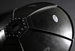

Eclipse is a high-volume manufacturer of next-generation products for the defense, aerospace, and microwave communications markets. The company has earned a reputation as a leader in developing advanced composite hardware that is designed to meet the rigorous standards of the U.S. military.
“Eclipse is the industry standard in SATCOM antennas,” says Jake Leikam, quality assurance engineer at Eclipse. “If you take a walk around the floor of any satellite show, you’ll see our products all over the place. We’re known worldwide as the best antennae out there.”
In 2006, Todd McNeill, veteran SATCOM engineer, founded Eclipse Composites in his garage (à la Apple). McNeill’s can-do company has been growing steadily ever since. Composite SATCOM antenna manufacturing is a unique and lucrative corner of the market. It’s also an evolutionary business in which things change, and change quickly.
“When we started, we were dealing with the X and Ku band and dealing with low .020 in.-.030 in. root mean square (RMS),” says Leikam. “RMS is a measurement of a surface’s deviations vs. its nominal or theoretical shape as defined by the CAD model. Along comes the Ka band, which is a more focused beam on a higher frequency… that’s where the tighter tolerances became critical for us to achieve, specifically because surface deviations or undulations affect reflectivity and therefore signal quality.”
“Ka is a high-frequency band that requires a higher precision,” says Andrew Pett, process engineer at Eclipse. “The whole surface of a Ka dish has to be within about a .010 in. RMS.”
