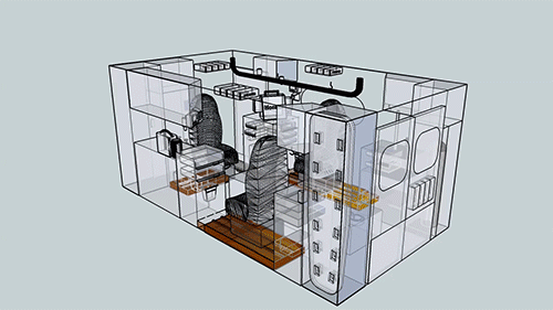

With a solid foundation in place, we turned our attention to the inside of the compartment. We took many of the issues the community identified during research and approached them with “human factors” in mind. Human factors are concerned with understanding how humans interact with their surrounding system—in this case how EMS providers interact with their patients and the workspace in the patient compartment. Based on the information collected, we developed more than 200 individual criteria that focus on improving seating and restraints, workspace, communications, storage, and other areas.
With a team of computer scientists, systems engineers, human factors experts, and a DHS contractor, we developed several new designs for patient compartments. Then we loaded the designs into simulation software so we could apply different emergency scenarios (e.g., cardiac arrest, trauma) and see if a provider could do everything he needed to do to provide care while remaining seated and restrained.
An animation of our ambulance design. Click image to play. Credit: NIST/BMT Designers and Planners
After we finished with that, we worked with NFPA and CAAS to make sure that they were incorporating human factors into their standards—things like how best to position the cot, equipment, cabinets, and needle disposal so that they were all within arms-reach of the EMS provider. They are defining what is “in arms-reach” in terms of where the majority of care will take place, the primary patient care position—where the EMS provider sits.
We also pushed for recessed overhead lighting, handle bar requirements, and clearance space around the provider’s head to limit the chances for severe head trauma. And lastly, as a complement to the standards, we worked with DHS and its contractor to develop the Ambulance Patient Compartment Human Factors Design Guidebook, which serves as a starting point for the design of new ambulances and contains best practices for human factors, lighting, climate control, and communication.
