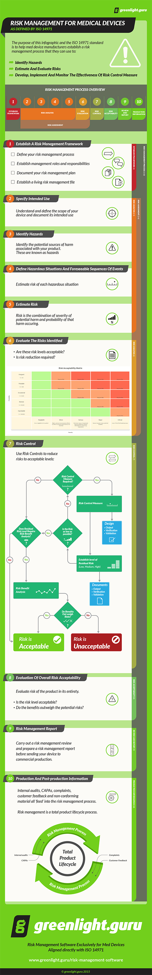

As noted, ISO 14971 describes an entire system approach for risk management, as summarized in the following chart.
Figure 2: An entire system approach for risk management as described in ISO 14971
In a nutshell, a risk management process should include:
• Risk management planning
• Risk analysis
• Risk evaluation
• Risk controls
• Overall residual risk acceptability
• Risk management report
• Risk management file
• Production and post-production information
As you can see, ISO 14971 describes an entire system. It’s a process intended to be applied throughout the entire life cycle of a medical device.
