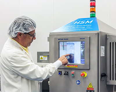

Photo courtesy of RAS / Photography – Rachel A Sale

Even at maximum speed there are no problems with false rejects. “The machine is very accurate,” reports Mejia. “The unit is programmable, and we can set the detection parameters,” he explains. In addition, he says, “We are able to check why a package was rejected.”
Software, recipes, and a touch screen operator interface simplify operation. Virtually no in-house maintenance is needed, and cleaning and sanitation requirements are minimal since incoming product is sealed. “I’m very pleased with it,” concludes Mejia.
