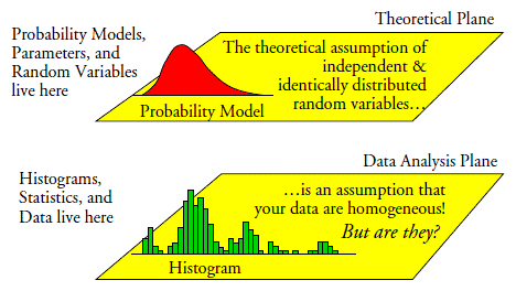

When we develop a statistical technique we begin with a probability model on the theoretical plane. Probability models are our starting point because they provide a mathematically rigorous description of how some random variable will behave. Using these models we can work out the properties of various functions of the random variables. Once we have a formula that works on the theoretical plane, we move from the theoretical plane to the data-analysis plane and use that formula with our data. In this way we have procedures that are consistent with the laws of probability theory. This allows us to obtain results that are both reasonable and mathematically justifiable. And that is how we avoid the trap of developing ad hoc techniques of analysis that violate the laws of probability theory and confuse noise with signals.
Figure 1: The theoretical plane and the data analysis plane
Clear thinking requires that we always make a distinction between the theoretical plane, where we develop our procedures and formulas, and the data analysis plane where we use them. Probability models, parameter values, and random variables all live on the theoretical plane. Histograms, statistics, and data live on the data analysis plane. When we use techniques of statistical inference we frequently have to jump back and forth between these two planes. When we fail to make a distinction between these two planes, confusion is inevitable.
So what are some of the differences between these two planes? While random variables are usually continuous, data always have some level of chunkiness. While probability models often have infinite tails, histograms always have finite tails. While parameters are fixed values for a probability model, the statistics we use to estimate these parameters will vary with different data sets even though these data sets may be collected under the same conditions.
These differences between theory and practice mean that whenever a procedure or formula developed on the theoretical plane is used on the data analysis plane the results will always be approximate rather than exact. This fact of life is one of the better kept secrets of statistical inference. However, if the procedure is sound on the theoretical plane, and if the formula has been proven to be reasonably robust in practice, then we can be confident that our conclusions are reliable in spite of the approximations involved in moving from the theoretical plane to the data analysis plane.

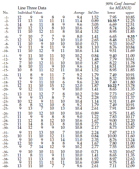

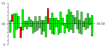

Our first example will use the data from Line Three. In order to illustrate how interval estimates work, I used these 200 data to compute a sequence of forty 90% confidence intervals for the mean, each based on five values. While intervals based on such small amounts of data will be fairly wide, the point here is to see how many of these 90% confidence intervals bracket MEAN(X).
The Line Three data and the 40 confidence intervals for the mean are given in figure 8. The histogram for Line Three is found in figure 4, and the forty confidence intervals are shown in figure 2. If we consider the grand average of 10.10 to be the best estimate for MEAN(X), then 37 out of 40, or 92.5 percent, of our intervals bracketed the mean. Thus, as expected, about 90 percent of our 90% confidence intervals work in this case.
Figure 2: Forty 90% confidence intervals for MEAN(X) for Line Three

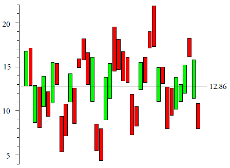

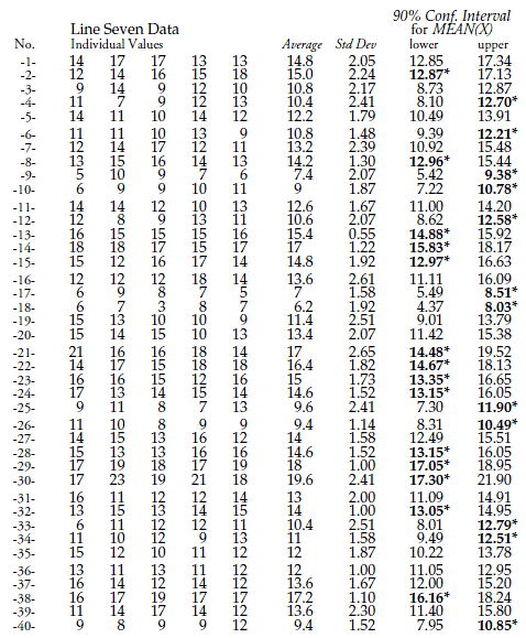

A second example is provided by the data from Line Seven. Once again, for illustrative purposes these 200 data are subdivided into 40 subgroups of size five and a 90% confidence interval for the mean is computed for each subgroup. The Line Seven data and confidence intervals are given in figure 9. The grand average for Line Seven is 12.86. The histogram is found in figure 4 and the forty 90% confidence intervals are shown in figure 3.
Figure 3: Forty 90% confidence intervals for MEAN(X) from Line Seven
Only fourteen of the forty 90% confidence intervals in figure 3 contain the grand average value of 12.86! Thus, rather than working about 90 percent of the time as expected, the 90% confidence interval formula only worked 35 percent of the time with these data! So why did this happen?

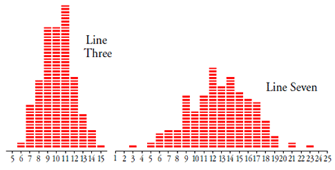

Figure 4: Histograms for Line Three and Line Seven
“Is this a problem with the ‘normality’ of the data?” No, not only are both data sets reasonably “normal,” but the t-test and t-based confidence intervals have been known for more than 60 years to be robust to departures from the normality assumption. The problem in figure 3 has nothing to do with the shape of the histogram. Instead it has to do with the theoretical assumption that the random variables will be independent and identically distributed.

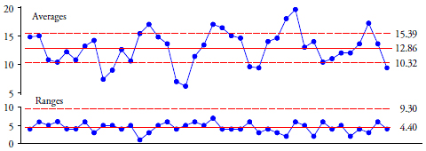

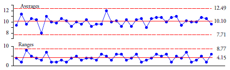

The process behavior chart is the premier technique for empirically checking for homogeneity. Unlike other statistical procedures which are gullible about the assumption of homogeneity, process behavior charts are skeptical about this assumption—they explicitly examine the data for evidence of a lack of homogeneity.
Figure 6: Average and range chart for Line Three
Figure 7: Average and range chart for Line Seven
The average and range chart in figure 6 shows that the data from Line Three are reasonably homogeneous, while that in figure 7 shows that the data from Line Seven are definitely not homogeneous. Any assumption that the data from Line Seven are identically distributed is inappropriate. There is not one process mean, but many, and the grand average of 12.86 is merely the average of many different things rather than being an estimate of one underlying property for this process.

Figure 8: 40 Subgroups of size 5 from line three
