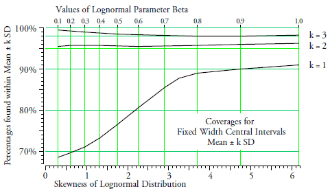

Figure 4 plots the areas for the fixed-width central intervals against the skewness of models from figure 2. The bottom curve of figure 4 (k = 1) shows that the areas found within one standard deviation of the mean of a lognormal distribution increase with increasing skewness. Since the tails of a probability model are traditionally defined as those regions that are more than one standard deviation away from the mean, the bottom curve of figure 4 shows us that the areas in the tails must decrease with increasing skewness. This contradicts the common notion about skewness and a heavy tail.
Figure 4: Coverages for fixed-width central intervals for lognormal distributions

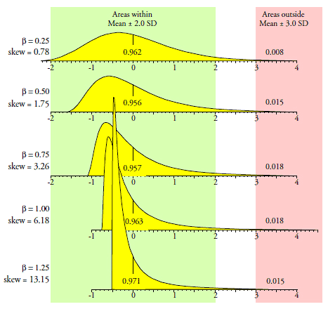

However, once again, there are a couple of surprises about this whole process. The first of these is the middle curve of figure 4 (k = 2) which shows the areas within the fixed-width, two-standard-deviation central intervals. The flatness of this curve shows that, regardless of the skewness, the areas within two standard deviations of the mean of a lognormal stay around 96 percent or more.
In statistics classes students are taught that having approximately 95 percent within two standard deviations of the mean is a property of the normal distribution. In parts one and two of this series we found that this property also applied to the families of Weibull and gamma models. Here we see that this property also applies to the lognormal distributions. Until the beta parameter gets larger than 1.00, lognormal distributions will have approximately 95.5 percent to 96 percent within two standard deviations of the mean.
The second unexpected characteristic of the lognormals is seen in the top curve of figure 4 (k = 3) which shows the areas within the fixed-width, three-standard-deviation central intervals. While these areas drop slightly at first with increasing skewness for the lognormals, they stabilize around 98 percent before beginning to climb back up. This means that a fixed-width, three-standard-deviation central interval for a lognormal distribution will always contain approximately 98 percent or more of that distribution.
So if you think your data are modeled by a lognormal distribution, then even without any specific knowledge as to which lognormal distribution is appropriate, you can safely say that 98 percent or more will fall within three standard deviations of the mean, and that approximately 96 percent or more will fall within two standard deviations of the mean. Fitting a particular lognormal probability model to your data will not change either of these statements to any practical extent.

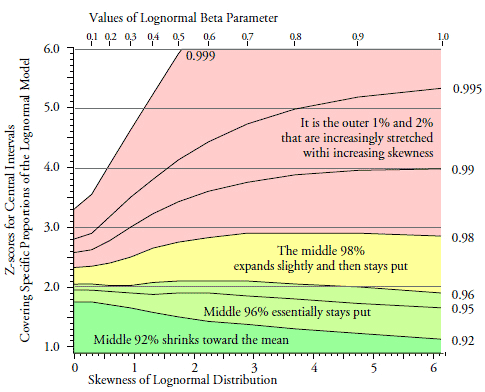

If the tail gets both elongated and thinner at the same time, something has to get stretched. To visualize how skewness works for lognormal models we can compare the widths of various fixed-coverage central intervals. These fixed-coverage central intervals will be symmetrical intervals of the form:
MEAN(X) ± Z SD(X)
While this looks like the formula for the earlier fixed-width intervals, the difference is in what we are holding constant and what we are comparing. Earlier we held the widths fixed and compared the areas covered by the intervals. Here we hold the coverages fixed and compare the widths of the intervals. These widths are characterized by the z-scores in figure 7. For example, a lognormal model with a beta parameter of 0.50 will have 92 percent of its area within 1.49 standard deviations of the mean, and it will have 95 percent of its area within 1.89 standard deviations of the mean.
Figure 7: Widths of fixed-coverage central intervals for lognormal models
Figure 8: Widths of fixed-coverage central intervals for lognormals
Figure 8 shows the values in each column of figure 7 plotted against skewness. The bottom curve shows that the middle 92 percent of a lognormal will shrink with increasing skewness. The 95-percent and 96-percent curves remain remarkably flat in the neighborhood of 2.0 standard deviations until the increasing mass in the center of the distribution eventually begins to pull these curves down. The 98-percent curve initially grows and then plateaus just below 3.0 standard deviations before it too begins to drop down with very high skewness.
The spread of the top three curves shows that for the lognormal models it is primarily the outermost 2 percent that gets stretched into the extreme upper tail. While 920 parts per thousand are moving toward the mean, and while another 60 parts per thousand get slightly shifted outward and then stabilize, it is primarily the outer 20 parts per thousand that bear the brunt of the stretching and elongation that goes with increasing skewness.

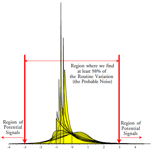

Figure 9: How three-sigma limits work with Weibulls, gammas, and lognormals
Shewhart’s approach was created for the continuing analysis of observational data that are the by-product of operations. To this end Shewhart used a fixed-width interval rather than a fixed-coverage interval. His argument was that we will never have enough data to ever fully specify a particular probability model for the original data. Moreover, since additional data will typically be available, we do not need to fine-tune our analysis—the exact value of the coverage is no longer critical. As long as the analysis is reasonably conservative it will allow us to find those signals that are large enough to be of economic importance without getting too many false alarms. So, for the real-time analysis of observational data Shewhart chose to use a fixed-width, three-sigma central interval. As we have seen, such an interval will routinely filter upwards of 98 percent of the probable noise.
What we have discovered here is that Shewhart’s simple, generic, three-sigma limits centered on the average will provide a conservative analysis for any and every data set that might logically be considered to be modeled by a Weibull, gamma, or lognormal distribution. As the reader may easily verify, it also works for any other mound-shaped or reasonable J-shaped probability model you might choose.
When we analyze observational data from our operations we only need limits that are conservative enough to keep false alarms from getting in our way as we look for the exceptional variation that is associated with process changes. Three-sigma limits are sufficient to do this because the difference between exceptional variation and routine variation is dramatic enough that we do not need a very sharp axe to separate the two.
This is why finding exact critical values for a specific probability model is not a prerequisite for using a process behavior chart. Once you filter out at least 98 percent of the probable noise, anything left over is a potential signal. As Bill Scherkenback said, “The purpose for collecting data is to take action.” And Shewhart’s three-sigma limits tell you when you need to take action and when to refrain from taking action. We only need watershed points to separate the bulk of the probable noise from the region of potential signals. Effort spent in fine-tuning the width of the limits to achieve a specific coverage is effort wasted.
