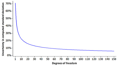

There’s an old joke about statisticians not knowing the difference between 30 and infinity, and figure 1 should shed light on its origin. Degrees of freedom, shown on the x-axis and hereafter referred to as “d.f.,” help to determine how precise, or “solid,” an estimate of standard deviation is, given its estimated uncertainty (the y-axis).1 Figure 1 shows that by the time an estimate of standard deviation is based on 30 d.f., it’s about as precise an estimate as it’s likely to get. (If 30 d.f. aren’t sufficient, getting up to 120 d.f.—a fourfold increase—is necessary to reduce the uncertainty by half.) This is potentially important because an estimate of standard deviation is essential to make an assessment of process capability possible.
Figure 1: Plot of uncertainty in standard deviation against degrees of freedom
Unfortunately, statistical language about d.f. is often met with blank looks and exclusion from the team intent on assessing process capability. Instead, ask, “How many data?” because this will lead to the more important question, “What’s the relationship between the number of data collected, d.f., and estimate uncertainty?”
The classical, global standard deviation statistic (STDEV in Microsoft Excel) applied to all the data in “one go” has d.f. = total number of values minus one. With 30 data, there are 30 – 1 = 29 d.f., and the uncertainty is 13.1 percent. However, this is not the method to use when working with capability.

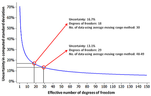

For example, let’s consider the case of individual values, which correctly starts with an assessment of capability using a process behavior chart (i.e., an XmR control chart for individual values). In an estimate of standard deviation from 30 data, there are 18 d.f., not 29, corresponding to an uncertainty of 16.7 percent. This estimate of standard deviation—hereafter called “SDwithin”—comes from the average moving range method (where SDwithin = “Average moving range” ÷ 1.128). Figure 2 renders this “detail” into a picture.
Figure 2: Reproduction of figure 1, but with the uncertainties and number of data associated with 18 and 29 degrees of freedom based on the average moving range method
While 18 d.f. does give a little more uncertainty than 29 d.f., figure 2 shows that 18 d.f. is a reasonable number—in part because the curve is on its way to plateauing. Hence, with about 15 or more d.f., an estimate of standard deviation has started to “solidify,” which lends credibility to the case for 30 data in a capability assessment (even if the original case may have been based on 30 d.f., implying 48–49 data and not ~30, when using an XmR chart).

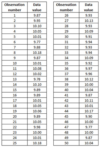

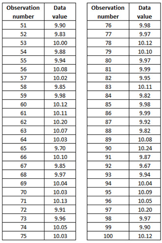

A stream of 100 individual values obtained as a byproduct of an ongoing manufacturing operation will be used. These 100 process data have an average of 9.99 and an estimate of SDwithin of 0.117, based on the average of the 99 moving ranges. The raw data are found in figure 3, with the classical, global standard deviation statistic being 0.110.
Figure 3: 100 values from a predictable process of average 9.99 and SDwithin of 0.117

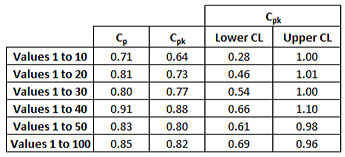

The data in figure 3 have been organized in six ways, leading to six different charts for individual values (see figure 4). A summary is below, including the effective number of d.f. and estimated uncertainties in each case:2

To complement the process behavior charts seen in figure 4, histograms are shown in figure 5, and the computed capability statistics are shown in figure 6.
Figure 5: Six different histograms, with the specifications of 9.5 (LSL) and 10.5 (USL) included, for the data in figure 4
Figure 6: Process capability statistics Cp and Cpk for the six different organizations of the 100 data. Columns four and five include the lower and upper confidence limits for Cpk.4
Given the context of these data, along with a thoughtful interpretation of figures 4, 5, and 6, how many data are needed to reach a “sound” conclusion about capability?
A judgment of 30 data, or approximately so, seems reasonable. Making do with just 10 or 20 values seems hard to justify. This is not because Cpk is suddenly > 1.3 with 30 or more data, as seen in figure 6, but because data are relatively easy to obtain, and the element of consistency from one production run to the next is well-assessed using roughly 30 data (30 data would be expected to cover six different production runs).
What about using all 100 data values? Aren’t more data better because they would give the lowest possible uncertainty in SDwithin? Not necessarily. Using fewer data (30 in this case) to arrive at a positive conclusion about capability means that monitoring the production process for continual process improvement could start earlier. By extrapolating the natural process limits—i.e., the 3-sigma limits on the chart for individual values—and charting new data as they come along, it would be possible to identify and deal with assignable causes of excessive variation. A manufacturer might prefer to use these extra data for improvement purposes, or for developing a capability statistic by reducing the uncertainty in it.
Finally, the confidence limits for Cpk are included in figure 6 to help confirm that, when using statistics, we live in an uncertain world. It’s left to the reader to contemplate how useful they are in reaching a good business decision.

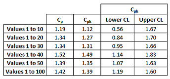

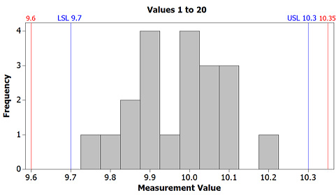

The context:
• Tighter specifications of 9.7 to 10.3 are now in place, the only difference compared to the data in case one.
• Compared to the statistics found in figure 6, the capability values are now smaller, as seen in figure 7. With a minimum capability requirement of 1.3, things look pretty bleak.
Figure 7: Process capability statistics based on the tighter product specifications of 9.7 to 10.3
Here, wouldn’t 10 data, and certainly no more than 20, be sufficient to reach a sound decision? The histogram for data values 1 to 20 is shown in figure 8; the location and width of the natural process limits (of 9.6 and 10.35) relative to the specifications (of 9.7 to 10.3) help to visualize why the capability statistics are lower than 1. This state of affairs provides pretty good justification for giving the process improvement team a call. How relevant is figure 1 for coming to this conclusion? We’ve also concluded that the process isn’t doing the job we need it to do, even though all measurements are in specification.
Figure 8: Histogram of data values 1 to 20, with the product specifications and the lower and upper natural process limits included

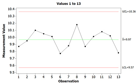

• After seven months 13 data values have been obtained (the data values 1 to 13 seen in figure 3—see column “Observation number”).
• Those “in the know” think that the process has been operating correctly and consistently during the last seven months, and this is expected to continue in the future.
Figure 9 shows the X chart for these 13 individual values. This chart, along with the context above, supports a characterization of process behavior as predictable.
Figure 9: Chart for individual values for data values 1 to 13 found in figure 3

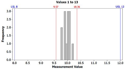

The histogram, with specifications and natural process limits included, is found in figure 10. Unlike case two, the location and width of the natural process limits relative to the specifications help to visualize why the capability statistics are much bigger than 1 (the capability statistics follow figure 10).
Figure 10: Histogram of the 13 individual values found in figure 9 with the specification limits of 8 to 12 also included
For these 13 data, the capability statistics are:
• Cp: 5.04
• Cpk: 4.96
• Cpk lower confidence interval: 2.97
• Cpk upper confidence interval: 6.95
Given these data and their context, would you be prepared to say that the process is capable, or would you keep your audience waiting at least six more months before offering an opinion? If you’re inclined to conclude yes (i.e., a positive conclusion on capability):
