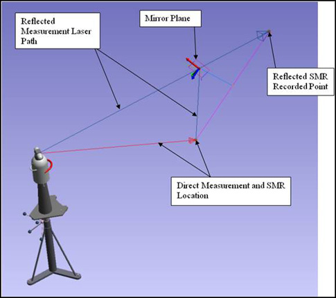

A mirrored surface can be measured with a laser tracker by measuring two points. The tracker is adjusted so that the laser beam is reflected off the surface of the mirror that is to be measured. Next, an SMR is placed on a stable stand so that it collimates the reflected laser beam. This is the first of the two required points. Next, the SMR is very carefully rotated so that it can be measured directly by the laser tracker. Great care should be taken to ensure that the SMR stand does not move. The direct measurement is the second required point. From these two points SpatialAnalyzer software, a product of New River Kinematics of Williamsburg, Virginia, is used to calculate the vector normal to the mirror and the position of the mirror plane. This method is explained graphically in figure 1.
Figure 1: Construction of a plane from two laser tracker measurements

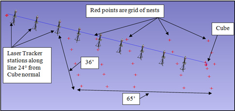

Figure 2: Distance test room layout
A line centered on the cube and extending to the corner of the clean room was laid out on the floor. This line was at approximately a 24° angle of incidence to the cube. In the SpatialAnalyzer job this line was called a “shoot line.” The angle of this line with respect to the cube was chosen for two reasons. First, the geometry of the room and cube position required a deviation from the cube normal to provide a 90-foot run. Second, 24° is not a very large angle of incidence and it wasn’t expected to affect measurement accuracy.
Laser tracker positions were marked on this line at 10-foot intervals out to 90 feet from the cube. The laser tracker was moved to each of these positions to measure the cube and grid of fixed nests. These measurements will yield cube-normal angles every 10 feet along the line that can be compared to the theodolite measurement of the cube-normal in the same coordinate frame to determine the tracker accuracy at distance.

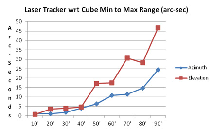

The first plot (Table 1) is of the range between the minimum and maximum data points at each distance station. The increase of the range between the minimum and maximum values at distance is due to the tracker uncertainty increasing with distance.
From the plots of the data, the range between the minimum and maximum data points at each station jumps from 0.0013° (4.56 arc-sec) at 40 feet from the cube to 0.0047° (17.15 arc-sec) at 50 feet and continues to increase as the distance between the tracker and the cube increases.

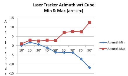

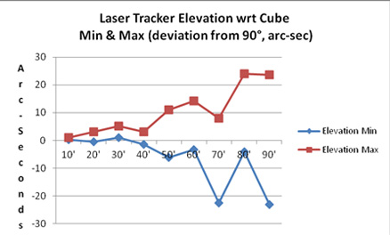

Next, the maximum and minimum values of the 10 measurements taken at each station were plotted for both azimuth and elevation and reported in Table 2 and Table 3.
Table 2: Min and max deviation, azimuth
Table 3: Min and max deviation from 90°, elevation
Tables 2 and 3 show the deviation of the azimuth and elevation extremes at each station. These numbers diverge with distance due to the tracker accuracy. The minimum deviation from 90° at 80 feet in elevation was out-of-family with the deviations at 70 feet and 90 feet. Otherwise the data deviates with distance as expected.

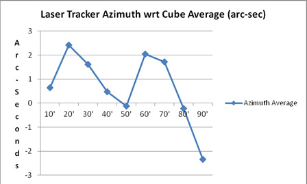

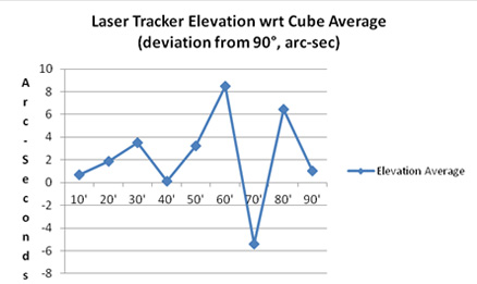

Finally the average of the 10 measurements taken at each station was plotted for both azimuth and elevation in Tables 4 and 5 respectively.
Table 4: Laser tracker average, azimuth
Table 5: Laser tracker average, elevation
Averaging the 10 samples at each station yields much lower errors, especially at longer distance.

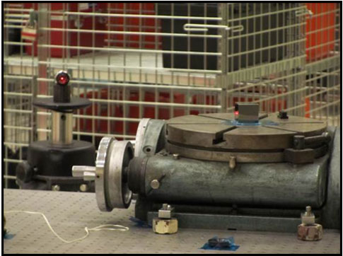

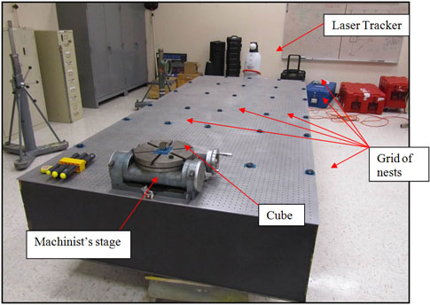

The second test in this study was to evaluate the effect of angle-of-incidence of a laser tracker’s laser beam with respect to a mirror cube while measuring the vector normal to the mirror cube. A machinist’s stage was secured to one end of a stable bench and the same Leica 901 tracker that was used for the distance test was set up at the opposite end. See figure 3. Next, a grid of 30 1.5 in. drift nests were bonded to the bench and measured by a Leica 901 laser tracker from five positions. The USMN feature of SpatialAnalyzer was used to optimize the uncertainty of the grid measurements. The machinist’s stage was used to rotate the mirror cube about the gravity vector in 10° increments. At each 10° increment the mirror cube was measured by both the laser tracker and 3D theodolite system with respect to the grid of points. Because the grid of points is common to both the tracker and theodolite data sets the two data sets can be compared and analyzed for accuracy.
Figure 3: Angle test layout
Figure 4: Laser tracker positions for USMN data set

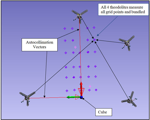

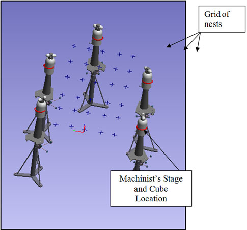

Four Leica TM 5100A theodolites were set up around the bench. Two of the theodolites were auto-collimated on the cube and measured a point on the cube using SpatialAnalyzer. The grid of points was measured with all four theodolites and the network was bundled. The bundle yielded the coordinates of each drift nests and the mirror cube. A coordinate frame was created on the mirror cube and called the baseline cube position. As the cube was rotated the theodolites were positioned so that two were collimated on the cube and the remaining two were positioned to achieve acceptable apex angles for the 3D theodolite measurements. This approach ensured that each cube position was related back to the baseline cube position and the drift nests, which yielded the cube rotation relative to the baseline position as well as correlating the theodolite data with the laser tracker data. See figure 5 for the theodolite setup around the cube and optical bench and a 3D theodolite system.
Uncertainty fields were created for each theodolite data set. The laser tracker data of the drift nests was imported and the laser tracker was used to measure the grid of points. Using USMN with point groups in SpatialAnalyzer these data were networked and optimized. The laser tracker was used to measure the mirror cube using two points 10 times. This measurement plan was repeated at each cube rotation position for a total of eight cube positions and 80 tracker data points.
Figure 5: Angle test measurement layout and 3D theodolite system

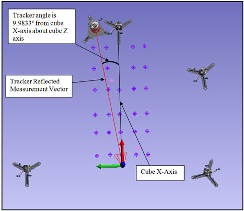

The USMN feature of SpatialAnalyzer was used to network the tracker data and the theodolite data into a single optimized network. The laser tracker beam was aimed at the mirror cube and an instrument stand was positioned so that an SMR in a nest mounted on the stand collimated the reflected laser beam. The laser tracker was used to measure the SMR 10 times, both reflected through the mirror and directly, alternating between direct and reflected measurements.

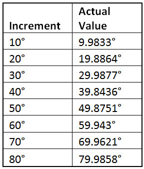

A line was created from one of the reflected measurements. The angle of this line with respect to the cube about the gravity vector was determined to be 9.9833° from the cube normal, therefore the first test was at 9.9833° from the cube normal. See figure 6. The test captured data from approximately 10° (9.9833° actual) to approximately 80° (79.9858° actual) in 10° increments. In order to simplify reporting these data, the increments were listed in even 10° increments. See Table 6 for the actual values.
Table 6: Angle test cube positions

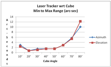

The first analysis was to compare the range of the minimum and maximum azimuth and elevation of the 10 measurements taken at each station. The range data yield the accuracy of the tracker in azimuth and elevation. These data are reported in both decimal degrees and seconds of arc.
Table 7: Laser tracker min to max range for azimuth and elevation
It can be seen that as the angle of incidence increases, the range from the minimum to maximum values also increases. The measurement uncertainty increases as the angle of incidence increases. Also note that the measurement at 10° had a higher error than at 20° through 50°. The small angle between the lines created by the reflected and direct measured points causes the angle calculation to be very sensitive. This yielded a higher uncertainty than angles of incidents that were greater than 10°.

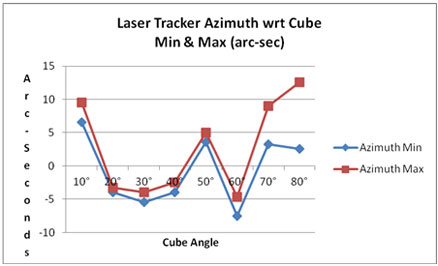

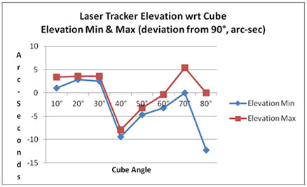

Next, the maximum and minimum values of the 10 measurements taken at each station were plotted for both azimuth and elevation. These data are provided in both decimal degrees and seconds of arc.
Table 8: Deviation of the azimuth and elevation extremes at each station
Table 9: Deviation of the azimuth and elevation extremes at each station
The previous plots show the deviation of the azimuth and elevation extremes at each station. Again, these numbers diverge as the angle of incidence increases with an elevated error at 10°. The scale of the graphs causes the numbers to appear to diverge from the actual cube angle, but the displacements are relatively small. What is important is the displacement between the minimum and maximum value at each cube angle.

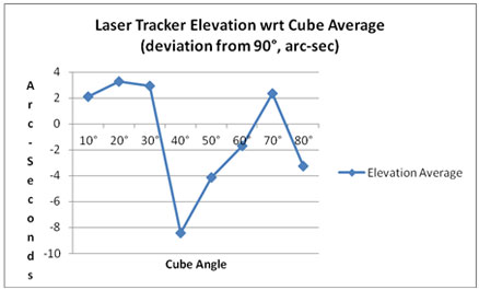

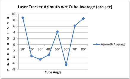

Finally the averages of the 10 measurements taken at each station were plotted for both azimuth and elevation. These data are provided in both decimal degrees and seconds of arc.
Table 10: Laser tracker average, azimuth
Table 11: Laser tracker average, elevation
Averaging these data yield azimuths from +8 arc-seconds to -6 arc-seconds across the 70° range in azimuth and +3 arc-seconds to -8 arc-seconds in elevation across the same range.

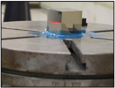

It should be noted that as the angle of incidence increased, the image of the laser beam on the cube distorted from a circular dot to a cigar-shaped smear. Figures 7 and 8 show the beam image at approximately 80°
Figure 7: Laser beam at 80°
Figure 8: Laser beam on cube at 80°
The laser tracker distance test yielded data that show a range of +/-5 arc-seconds for data sets of 10 samples out to 50 feet. Beyond 50 feet, the uncertainty increases with distance. This error is due to the laser tracker uncertainty. It should be noted that the uncertainty dropped to +/-2.5 arc-seconds in azimuth and +8/-6 arc-seconds in elevation when data sets at each station were averaged.
At distances of 50 feet or less, a mirrored surface can be measured by a laser tracker with acceptable accuracy. Multiple mirror measurements (10 or more) should be taken at any distance to ensure that the SMR is stable. The SMR should be rotated between each direct and reflected shot to ensure stability. At distances greater than 80 feet, large data sets (20–50 mirror measurements) should be taken and averaged for acceptable uncertainty.
The laser tracker angle test showed that at 10°, the uncertainty was 10 arc-seconds in azimuth and 4 arc-seconds in elevation. At 20° the azimuth uncertainty dropped to -3 arc-seconds and elevation stayed the same. Past 30° the uncertainty oscillated between -5 arc-seconds and +12 arc-seconds for azimuth and -12 arc-seconds and +5 arc-seconds for elevation, increasing with angle. The instability of these measurements is believed to be due to the measurement method. In the distance test, the cube and the theodolites were stationary and only the measuring tracker moved. In the angle test the cube and theodolites moved while the tracker remained stable. For each station the theodolites required a completely new setup. These multiple setups could have caused the cube angles to change slightly which may cause data to appear to oscillate. Fortunately data extremes do fall within levels that are acceptable for many measurements.
It should be noted that the tracker was able to measure the cube when the angle of incidence was 80° and return data with lower than expected uncertainty.
When measuring mirror cubes at varying angle of incidence from the laser tracker, multiple data points should be taken and averaged, especially when the angle of incidence is greater than 50°
At an angle of incidence below 50°, a mirrored surface can be measured with acceptable accuracy. It should be noted that at 10° or less the uncertainty is slightly higher but still fewer than 3 arc-seconds. Multiple mirror measurements (10 or more) should be taken at any distance to ensure that the SMR is stable. The SMR should be rotated between each direct and reflected shot to ensure stability. At an angle of incidence above 50° the uncertainty increases with increased angle. At angles of incidence greater than 50° large data sets (20–50 mirror measurements) should be taken and averaged for acceptable uncertainty.
