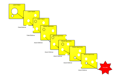

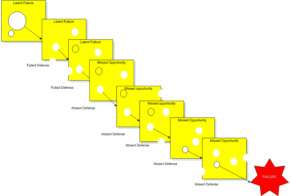

If you've ever taken part in a failure investigation, you may have seen a diagram, or even produced the diagram yourself, that illustrates all the failure points in the system that produced the undesirable outcome. A perfect storm of a problem, the failure points were precisely aligned in layer upon layer of Swiss cheese slices, creating an aperture through which a bullet could pass without resistance, hitting the failure target.
Figure1: Adapted from the "dynamics of accident causation" model, or Swiss Cheese model, from James Reason, 1990. Click for larger image.
During the 1990s, James Reason, a professor at the University of Manchester in the United Kingdom, did extensive research on the psychology of human nature and wrote a textbook. I refer to his book on a weekly basis. Although he is more of a guru of safety, I firmly believe that Reason's research should be read and applied to the field of general business. And his research should be embraced by quality professionals particularly.
Granted, if you spend time with safety professionals, many will be very familiar with his research. That's because it is used to express many different failings in an accident. However, the Swiss cheese model, as useful as it is to express the causal factors or failures in the defense mechanism, is not the element of Reason's research that aids me in my daily pursuit of excellence. It is something more fundamental; it's Chapter 7 from his book, Human Error (Cambridge University Press, 1990), "Latent errors and systems disasters."

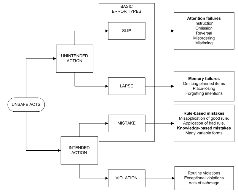

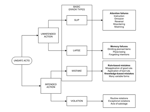

In Chapter 7 of Human Error, Reason discusses "unsafe acts." In the failure example above, I'll interpret unsafe acts as "acts that lead to poor quality." In section 10.2.4, Reason writes, "An unsafe act is more than just an error or a violation—it is an error or a violation committed in the presence of a potential hazard." Therefore if the hazards of poor quality are present when a poor-quality act is done by an individual, it will only lead to an undesired outcome. The slices of Swiss cheese have aligned, and the bullet has passed through without deflection.
In the same section, Reason published a model that describes this graphically and more simply than I can express in writing:
Figure 2: James Reason's summary of the psychological varieties of unsafe acts, classified initially according to whether the act was intended or unintended, and then distinguishing the errors from violations—Human Error (Cambridge University Press, 1990). Click for larger image.
So what would my learning be from this investigation and research? We all have this thing called "decision making" or "free will," and it is here I recommend that this has to be addressed. If we can help people make better and more informed decisions in the presence of poor-quality hazards (presuming poor-quality hazards cannot be eliminated), then we will prevent an undesired outcome. Some call this culture change; others see it as systems thinking. I view this as maturity.
