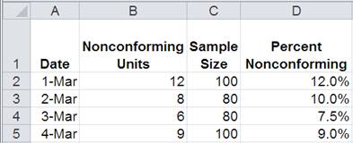

Services are concerned with two things: defects (i.e., mistakes, errors, omissions, etc.) and turnaround times. So for most defect-related applications we need a date, the number of defects, the sample size (total number of opportunities for a defect), and the percentage of nonconforming units. These four columns give you the ability to create p charts, u charts, or XmR charts (aka the X and moving range chart or the Individuals chart)—the most common charts in service industries. For ease of charting, organize the data in columns, not rows. Figure 1 shows what the column headings would look like in Microsoft Excel.
Figure 1: Example of column headings in Microsoft Excel

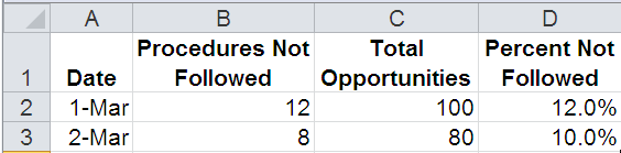

One of our customers have asked me, “I have a back room operation; how do I track the number of times people don’t follow established procedures?”
“Simple,” I replied. “Just adapt these columns to your data.” The result is shown in figure 2.
Figure 2: Adapting columns to your data

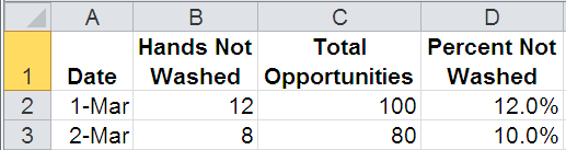

In health care, hospitals track hand washing, because hand washing is the key to preventing hospital acquired infections that, according to the Centers for Disease Control and Prevention, kill 99,000 people a year. Figure 3 shows how the data would appear.
Figure 3: Tracking hand washing in a hospital

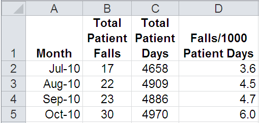

This format can also be used for defect data concerning patient falls, infection rates, and other hospital events. See figure 4.
Figure 4: Patient falls as defect data
Once you understand the nonconforming/sample/ratio format for defect data, it’s easy to lay out data for charting. Using the Excel add-in, QI Macros, it’s easy to create p, u, or XmR charts from this data. Use nonconforming/sample size (columns A:C) for p or u charts; use the ratio (column A and D) for XmR charts.

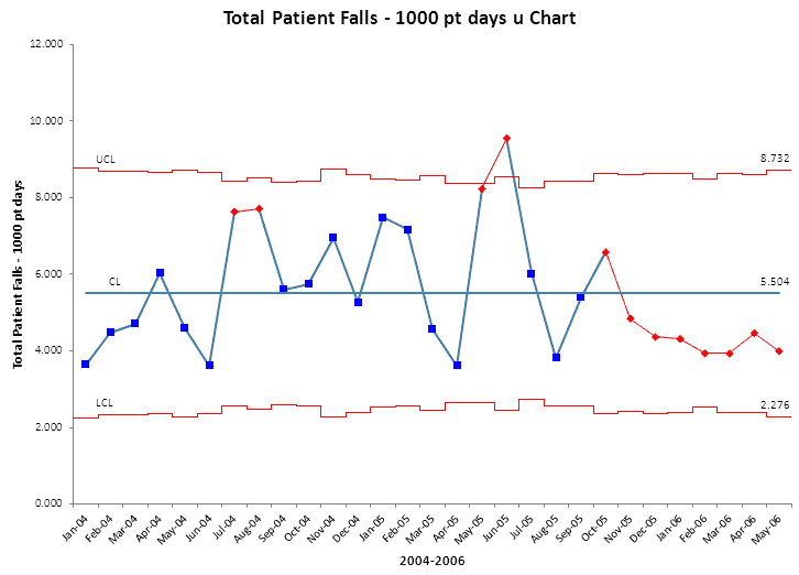

Note: The difference between a p chart and a u chart (see figure 5) is that in a p chart the item is either bad or good. In a u chart, the item can have more than one defect. In this case a single patient can fall more than once.
Figure 5: U chart of total patient falls—1000 pt days. Click for larger image.

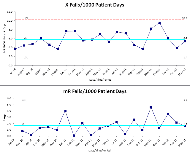

Figure 6: XmR chart—falls/1000 patient days. Click for larger image.
I often provide both types of charts because the variable limits of a p or u chart sometimes confuse the viewer. Having to explain why the limits vary sometimes takes detracts from what the data is telling us.

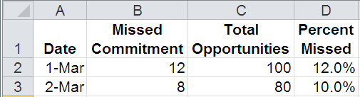

From a turnaround time perspective, service industries often track response times on a pass/fail (i.e., defect) basis: number of calls answered in 60 seconds (call center), number of cardiac patients given aspirin at arrival (emergency room), number of quotes delivered within 24 hours (insurance) and so on. This takes on the form of having met or missed a service commitment as shown in figure 7.
Figure 7: Tracking response time for services can be shown as a having met or missed a service commitment
While most managers like to know how well they are doing (% of commitments met), Six Sigma problem-solving methods work best when focused on the problem (% of commitments missed). Figure 8 shows managerial performance data.
Figure 8: P chart of missed commitment—total opportunities. Click for larger image.

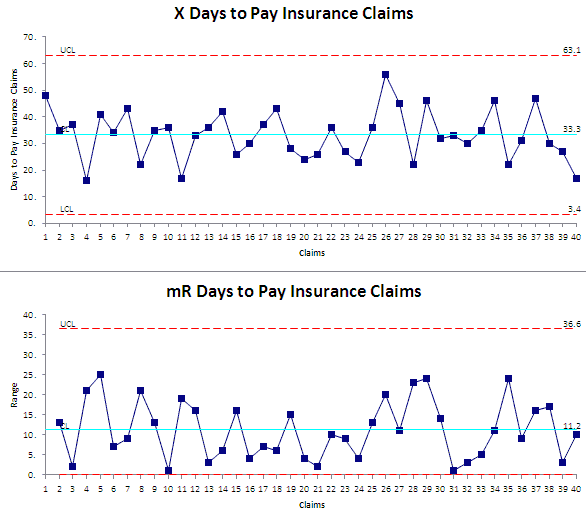

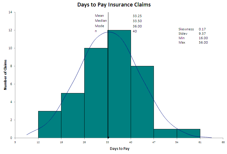

When there are no headings and the data represents, for example, patient-by-patient or claim-by-claim turnaround times, the data can be easily charted as an XmR chart (figure 10) or histogram (figure 11) using the QI Macros.
Figure 10: XmR chart—days to pay insurance claims. Click for larger image.
Figure 11: Histogram—days to pay insurance claims. Click for larger image.
In this example, we can see that the process for paying claims is stable, but we might incur additional charges for exceeding 30 or 45 days before claims are paid, depending on the supplier’s requirements.
