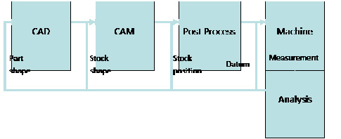

Simple probing macros are not sufficient for locating more complex components, but the probing and alignment techniques from direct computer controlled coordinate measuring machine (DCC CMM) inspection software can be used to run similar measuring sequences directly on machine tools.
The alignment techniques common in inspection software can allow more sophisticated optimization. In particular, “best fitting” operations, which optimize the positioning of measurement results against CAD surfaces, can be used to optimize the position of complex free-form surfaces, either by minimizing the differences from nominal (least squares best fit) or using tolerances to take the amount of stock into consideration.
When more sophisticated software-based solutions are used, two different approaches can be used to update the machining programs to match the measured position:
Modifying the work offset, as with basic probing-based part setup. This is preferred for batch manufacturing because it allows existing, proven machining programs to be reused. A standard machining program is used every time, but the work offset is adjusted slightly to match the measurement.
Modifying the tool paths. This involves transferring the optimized alignment from the measuring software to the machining software. The work offset is not changed, but the tool paths are recalculated to match the required datum position. This is more versatile if significant alignment changes are required but requires verification of the new machining programs. This is the basis of “adaptive machining” techniques discussed later.

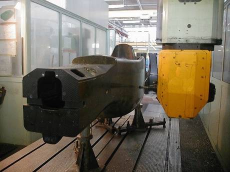

The Eurofighter Typhoon is a combat aircraft, and its wing platform is a delta wing (deltaplane) that uses a stabilator-
After forming, the excess material from the super-plastic forming process must be milled so that the machined surface blends closely with the adjoining airfoil surfaces. The shallow, tapered shape adds to the difficulty of the blending process.
Original process
The original process involved locating the foreplane manually on a fixture to machine one side of the part. The operators then turned the component over and relocated it in a different fixture. This was repeated two more times, each time with a different fixture. The quality of the part depended entirely on the ability of the operators to adjust the foreplane and machining supports according to the fixture datums.
This four-stage setup process compensated successfully for the variability of the super-plastic forming process but was unsatisfactory in several respects. The quality was inconsistent due to the variability of the manual setting operations, so manual reworking was an integral part of the process. The process also took many hours, and the time required varied greatly, making scheduling difficult.
Revised process
The original fixtures have been replaced with a single vacuum fixture that holds the part centrally with significant overhang. This eliminates the need to turn the part over because the key areas can be machined in a single operation. The manual setup operations have been replaced by an automated, measurement-based part alignment process:
• The part is roughly positioned (to an accuracy of 4 mm) and secured on the vacuum fixture.
• The operator runs the software and enters part details, which are logged to ensure traceability.
• A five-axis probing program measures a series of key points on the part surface.
• The software uses the measurement results to calculate an optimized workpiece alignment and checks that the amount of movement required is within predefined tolerance limits.
• The software applies the optimized alignment to the machine by uploading a numerical controlled program that adjusts the work offset.
• The finish machining part programs run in the optimized alignment to create a perfect component.

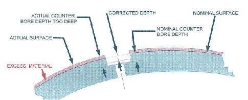

Many composite parts include drilled holes that are used for assembly purposes. Often the top of the rivet or bolt is kept flush with the surface by using a counter bore. Composite materials can vary in thickness for a variety of reasons, especially with open-mold processes, and this can cause significant problems with counter bores. If the counter bore is too deep, there may not be enough material for a durable joint. If the counter bore is not deep enough, the appearance and the aerodynamics will be compromised.
Adaptive machining can be used to overcome surface variation by measuring the part (either in part or as a whole) and mapping the actual surface. These measurement results are used to reshape or adapt the nominal shape of the part accordingly.
