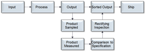

Quality case in point: Back in the early days of understanding quality, we definitely had an “it is what it is” mentality. Defects and nonconformances were perceived as inevitable; the best we could do was to inspect out the bad ones. Stuff would come into a process, we would do something to it, stuff would come out of the process, and because defects were inevitable, we would sort through it to find as much of the bad stuff as we could and sell the rest.
For high-volume stuff, we used various sampling plans designed to reduce the risk of rejecting a lot with an “acceptable” level of defects. (For a lot more on this, see my articles, “Psst, Hey Buddy, Wanna Fix?” and “Acceptable Losses?”) Basically, the thinking was that since defects are inevitable, let’s make sure we don’t penalize the producer too much for making at least a predictable amount of them.
This is an early form of process control, and is shown graphically in figure 1 below.

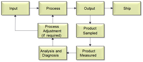

That was the dawn of the process control era. We were almost ready to give up our belief in the inevitability of defects and nonconformances, but first we had a stage to go through to learn that. We still sampled the process output, but now we used statistical process control charts as a heuristic tool to determine when it made sense to react by adjusting the process, rather than waiting until we went out of specification or had a defect and began inspecting and sorting the product. First, it is cheaper to adjust a process than to sort and scrap the product, and second, because of the way control charts work, you can detect problems in the process before it gets bad enough to go out of spec or cause a defect. Process control is illustrated in figure 2 below.
Figure 2: Process control 1, circa 1980
It didn’t take long, running a process with this new approach, before we started realizing that maybe defects and nonconformances were not, in fact, inevitable consequences of a process. Now that we were detecting and reacting to external variation with process adjustments (i.e., “special causes”), we also began to see processes exhibit less variation and stay on target. In so doing, our old processes, which had produced “inevitable” defects, now were fully capable of producing defect-free and within specifications.

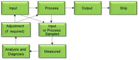

However, there is a substantial problem with this form of process control: We are still measuring after the process, so when we find a problem, it might be too late, at least for that unit. Pretty quickly, the next obvious step was taken. Rather than measuring the output and adjusting based on what had already happened, we measured the input and the process itself to see if they were where they needed to be to produce the output we wanted, as shown in figure 3 below.
Figure 3: Process control 2, circa 1990
In order to move upstream like this, though, we have to learn about the relationship between our inputs and our process variables, and how they affect the outputs that we’re trying to achieve. That’s done by industrial research of one form or another and can easily be documented on a quality function deployment-type matrix. Lacking that process knowledge is probably why some businesses are stuck on process control 1. If we’re in this phase of process control, we expect high conformance to target and no defects.
