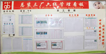

The second thing that was obvious was that management was using visual displays to keep everyone informed and interested. There was no way that you could miss the large information boards that were placed in every natural work team’s area. Of course, everything was in Chinese, and the only thing I could understand was the pictures of the workers with smiles on their faces. I noted that there were about 25 pictures on one board, and there were three drawings of a sad face.
Zhu explained that the pictures were of people in the department who were functioning at the zero defect level. The picture of the sad face with the names under them were people who were not working at the zero defect level. He went on to explain that each day, the quality level of every employee is evaluated and posted on the information board. He explained that the salary of each employee was also posted there, and that 25 percent of each employee’s salary is based on the quality of his work. We later learned that each employee’s salary was also based on the number of different operations she was trained on and able to perform. Zhu pointed out that increased productivity at the individual operator’s level was not important because the production lines were balanced, and there was little or no stock between operations. It was essential that they were able to meet the standard, but increases over and above standard would only mean that the individual would be out of work until the next part comes to them.
When we questioned if posting everyone’s salary was a good thing to do, he replied that they do not hide anything from their employees. Everyone knows the problems they are having with the production schedule and the way the organization is performing. The information board also had posted on it the organization’s mission, objectives, vision, and quality policy statements.

I stopped at one information board because there were two pictures of parts and equipment posted on it. When I inquired what these were, Zhu explained that they were things that were found not to be in the place that they should be. When that occurs, they take pictures of them and post them. This helps everyone to keep practicing 5S.

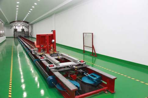

In another part of the laboratory there was a crash test unit where baby car seats were tested to measure the stress that an infant would be subjected to if the car was in a crash. The lab used different-sized dummies, from a toddler to a large child, to evaluate the stress based upon the different sizes and weights of the children. These tests were done on all new designs and repeated periodically during the production phases to be sure that there had not been a negative change due to changes in the production process and incoming materials. During the impact a series of microsecond pictures were taken, and hundreds of sensors were used to study the stresses put on the child when they were properly strapped into the car seat.
