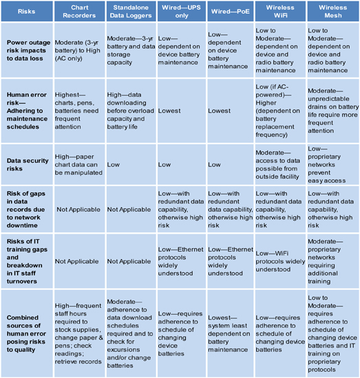

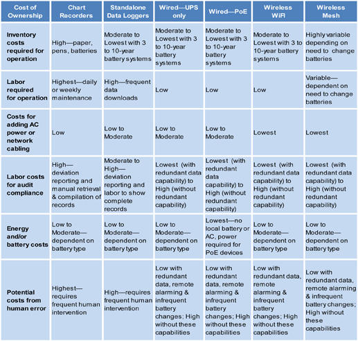

Each method of communicating data has its advantages and disadvantages. When it comes to regulatory-compliant applications involving public health, however, the criteria for using one method over the other should be well understood. The following two charts provide an overview of risk factors and cost-of-ownership differences between the continuous monitoring systems.
Figure 1: General guidelines to risks associated with meeting GMP requirements
Figure 2: General guidelines for some of the more salient factors affecting costs of ownership related to the six monitoring options. Varying plant sizes and scale of operations affect the impacts of various cost factors.
During the last decade, nearly every leading pharmaceutical company that had relied on paper-chart recorders either replaced them with a network-based system or is in the thinking stages of doing so. Chart recorders can still be found in the marketplace that cost as little as a few hundred dollars. Most pharmaceutical quality managers consider this technology to be obsolete due to the considerable costs of maintaining chart recorder-based monitoring systems and the obvious risks of handling paper-based records with limited or no alarm notification. Costly staff hours must be devoted to tracking which charts must be changed when, and which batteries need to be changed in what intervals. AC power-based chart recorders without batteries offer no ability for continuous data records in the event of power outages.
Auditors are aware that chart recorders rely on humans for daily or weekly checks to replace paper, check pens, and write deviation reports. The possibilities for human error are multifold. Although to date there have been no known instances of regulators rejecting chart recorder-based monitoring systems, these agencies do encourage moving away from manually-intensive processes toward more automation to tighten up quality systems and make better use of resources.
Unlike paper chart recorders, standalone data loggers are not as likely to break. They do, however, incur considerable labor costs for manually downloading data, especially in large plants where hundreds of data loggers are required to ensure environmental standards in both processing and storage areas. These costs are magnified in the current environment where inspection-readiness can be an issue—keep in mind the FDA's 15-day period for responding to observational deficiencies. Operational costs for complying with regulators' requests for information, and the interference with normal operations that audits can involve, can be considerable. As with chart recorders, the capability to access accurate and complete records throughout the record-retention period as required by FDA 21 CFR Part 11 and EU GMP Annex 11 may be compromised if it takes too long to the locate records or they are incomplete.
There are also multiple human-error sources with systems based on standalone data-loggers. First, staff may neglect to download data before the instrument's storage capacity is exceeded. Second, battery-powered standalone data logger systems also require ongoing monitoring of batteries, which creates an opening for lost data. Third, AC-powered data loggers without batteries may not provide gap-free records in the event of power outages.
If one considers technological investments as ways to automate routine tasks to eliminate the costs of labor and potential human error, then standalone data loggers do not generally pass muster. Relying on human labor to download data, investigate overlooked deviations, and maintain these files opens the door to regulatory objections and the staggering costs that ensue with production delays. With the exception of monitoring the contents of a few chambers, standalone recorders put undue risk on companies more than automated monitoring methods.
