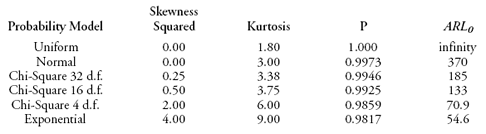

This argument begins with the assumption that three-sigma limits are based on a normal distribution, and therefore the normal theory coverage of P = 0.9973 for three-sigma limits must be a characteristic of the process behavior chart. When three-sigma limits are used with other probability models we immediately find that we end up with different coverages P. So what do these different values of P mean? By analogy with other statistical procedures which are characterized by the risk of a false alarm, or alpha level, these different coverages P are converted into the sequential equivalent: the average run length between false alarms, or ARL0. These average run length values are then interpreted as a characterization of how the three-sigma limits will work with different probability models.
When signals consist of points outside the three-sigma limits a well-known result establishes that the theoretical ARL0 values will simply be the inverse of [1–P]. Thus, the normal theory value for P of 0.9973 corresponds to an ARL0 of 370. See figure 1 for the results for some other probability models.
Figure 1: Average run lengths for six probability models
The smaller ARL0 values for the skewed models are cited as evidence that the process behavior chart does not work with skewed data. These values are interpreted to mean that the chart will give too many false alarms. Therefore, skewed data need to be transformed to make them look “more normal.” This is said to reduce the number of false alarms and make the chart work more like it does in the normal theory case. Thus, it is said that any analysis should begin with a test for normality. If there is a detectable lack of fit, then a normalizing transformation is needed before the data are placed on a process behavior chart.

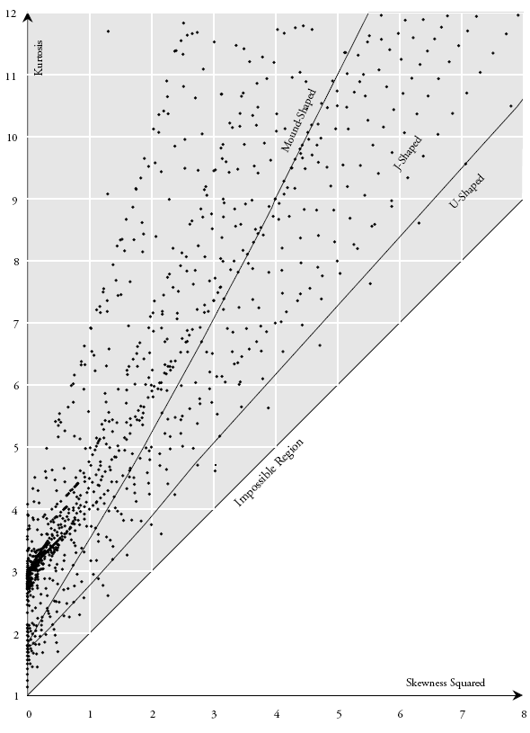

To illustrate what happens in practice, I decided to look at different probability models and to compute the area under the curve included within the “three-sigma interval” defined by the parameters:
I began with 100 binomial distributions. Next I looked at 112 Poisson distributions, 43 gamma distributions, 100 F-distributions, 398 beta distributions, 41 Weibull distributions, and 349 Burr distributions. These 1,143 distributions contain all of the chi-square distributions, and they cover the regions occupied by lognormals, normals, and Student t distributions. They include U-shaped, J-shaped, and mound-shaped distributions. Since each of these probability models will have a skewness parameter and a kurtosis parameter, we can use the values of these two shape parameters to place each of these 1,143 distributions in the shape characterization plane.
In figure 2 each of the 1,143 probability models is shown as a point in this shape characterization plane. For any given probability model the horizontal axis will show the value of the square of the skewness parameter, while the vertical axis will show the value for the kurtosis parameter. The lines shown divide the shape characterization plane into regions for mound-shaped probability models, J-shaped probability models, and U-shaped probability models.

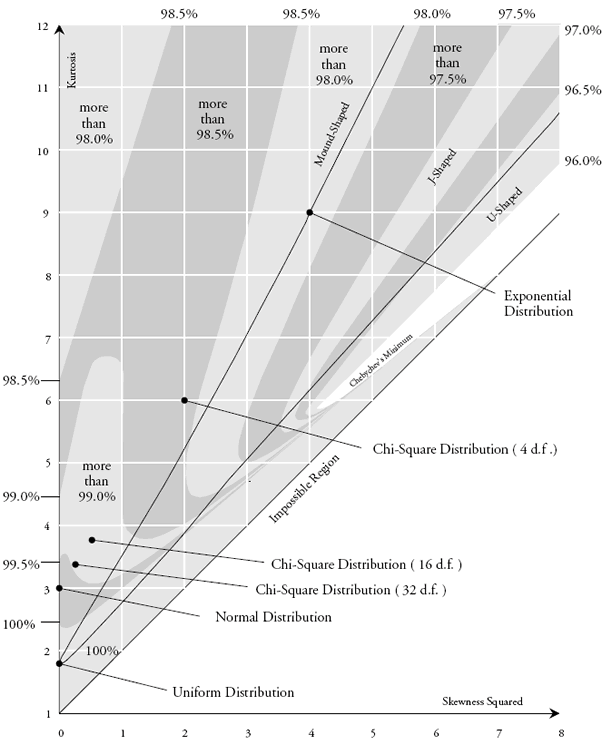

By considering the coverage of the three-sigma intervals for these 1,143 models I was able to construct the contour map shown in figure 3.
Starting on the lower left, the bottom region is the region where the three-sigma interval gives 100% coverage. The slice above this region shown by the darker shading is the region where the three-sigma interval will give better than 99.5-percent coverage. Continuing in a clockwise direction, successive slices define regions where the three-sigma intervals will give better than 99-percent coverage, better than 98.5-percent coverage, better than 98-percent coverage, etc. The six probability models of figure 1 are shown in figure 3. This will allow you to compare the P values of figure 1 with the contours shown in figure 3.
Figure 3: The coverage of three-sigma limits
Inspection of figure 3 will reveal that three-sigma intervals will provide better than 98-percent coverage for all mound-shaped probability models. Since most histograms are mound-shaped, this 98 percent or better coverage hints at why Shewhart found three-sigma limits to be satisfactory in practice.
Further inspection of figure 3 will show that most of the J-shaped probability models will have better than 97.5-percent coverage with three-sigma intervals. Since these models tend to cover the remaining histograms we find in practice, we see that three-sigma limits actually do much better than the Chebyshev inequality would lead us to believe.
In the U-shaped region most of the probability models will have 100-percent coverage. However, some very skewed and very heavy-tailed U-shaped probability models will fall into the Chebyshev minimum. Offsetting this one area of weakness is the fact that when your histogram has two humps it is almost certain that you are looking at the mixture of two different processes, making the use of three-sigma limits unnecessary.
Thus, when the process is being operated predictably, Shewhart’s generic three-sigma limits will result in values of P that are in the conservative zone of better than 97.5-percent coverage in virtually every case. When you find points outside these generic three-sigma limits, you can be sure that either a rare event has occurred or else the process is not being operated predictably. (It is exceedingly important to note that this is more conservative than the traditional 5-percent risk of a false alarm that is used in virtually every other statistical procedure.)
Why were figures 2 and 3 restricted to the values shown? Can not both skewness and kurtosis get bigger than the values in figures 2 and 3? Yes, they can. The choice of the region used in figures 2 and 3 was based on two considerations. First, whenever you end up with very large skewness or kurtosis statistics it will almost always be due to an unpredictable process. When this happens the skewness and kurtosis statistics are not a characteristic of the process, but are describing the mixture of two or more conditions.
Second, predictable processes are the result of routine variation. As I showed in my May column (“Two Routes to Process Improvement”) routine variation can be thought of as the result of a large number of common causes where no one cause has a dominant effect. In other words, a predictable process will generally correspond to some high-entropy condition, and the three distributions of maximum entropy are the normal distribution, the uniform distribution, and the exponential distribution. Figures 2 and 3 contain these three distributions and effectively bracket the whole region of high-entropy distributions that surround them. When considering probability models that are appropriate for predictable processes we do not need to go further afield. The region shown in figures 2 and 3 is sufficient.
Any statistical technique that is used to detect signals can be characterized by a theoretical power function. With sequential procedures a characteristic number that is part of the power function is the average run length between false alarms (ARL0). As we saw in figure 1 , the ARL0 value will be the inverse of [1 – P].
Of course, when we invert a small value we get a big value. This means that two values for P that are close to 1.00, and which are equivalent in practice, will be transformed into ARL0 values that are substantially different. Interpreting the differences in the ARL0 values in figure 1 to mean that we need to transform our data prior to placing them on a process behavior chart is nothing more or less than a bit of statistical slight-of-hand. There are three different problems with using the ARL0 values in figure 1 to argue that we need to have “normally distributed data.”
The first problem with figure 1 is that this is an inappropriate use of the ARL0 values. Average run length curves are used to compare different techniques using the same probability model. The ARL0 values are merely the end points of these ARL curves. As the end points they are not the basis of the comparison, but only one part of a larger comparison. It is this comparison under the same conditions that makes the ARL curves useful. Using the same probability model with different techniques creates a mathematical environment where the techniques may be compared in a fair and comprehensive manner. Large differences in the ARL curves will translate into differences between the techniques in practice, while small differences in the ARL curves are unlikely to be seen in practice. But this is not what is happening in figure 1. There we are changing the probability model while holding the technique constant. As we will see in the next paragraph, regardless of the technique considered, changing the probability model will always result in dramatic changes in the ARL0 values. These changes are not a property of the way the technique works, but are merely a consequence of the differences between the probability models. Thus, the first problem with figure 1 is that instead of holding the probability model constant and comparing techniques, it holds the technique constant and compares probability models (which we already know are different).
The second problem is that the differences in the ARL0 values in figure 1 do not represent differences in practice. By definition, the ARL0 values are the inverses of the areas under the extreme tails of the probability models. Since all histograms will have finite tails, there will always be discrepancies between our histograms and the extreme tails of our probability models. Given enough data, you will always find a lack of fit between your data and any probability model you might choose. Those who have studied lack-of-fit tests and are old enough to have computed the various lack-of-fit statistics by hand will understand this. Thus, the differences between the ARL0 values in figure 1 tell us more about the differences in the extreme tails of the probability models than they tell us about how a process behavior chart will operate when used with a finite data set. Thus, the second problem is that the most artificial and unrealistic part of any ARL curve is the ARL0 value.

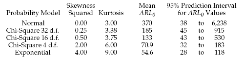

The third problem with the ARL0 values in figure 1 is the fact that they are computed under the assumption that you have an infinite number of degrees of freedom. They are expected values. In practice the three-sigma limits will vary. If we take this variation into account and look at how this variation translates into variation in the value for P for different probability models, then we can discover how the ARL0 values vary. In figure 4, the limits are assumed to have been computed using 30 degrees of freedom. The ARL0 values shown correspond to the P values that correspond to the middle 95-percent of the distribution of computed limits. As may be seen the differences in the Mean ARL0 values disappear in the overwhelming uncertainties given in the last column. Moreover, there is no practical difference in the lower bounds on the ARL0 values regardless of the probability model used. This is why transforming the data will not improve your ARL0 to any appreciable degree. Thus, the third problem with comparing the Mean ARL0 values is that the routine variation in practice will obliterate differences seen in figure 1.
Figure 4: Average run lengths for limits having 30 degrees of freedom
Therefore, while the argument presented at the start of this column has been used to justify transforming data to make them “more normal” it does not, in the end, justify this practice. The whole argument, from start to finish, is based on a strong presumption that the data are homogeneous and the underlying process is predictable. Of course, according to the argument, the purpose of the transformation is to make the data “suitable” for use in a technique that is intended to examine the data for homogeneity. Thus, this argument could be paraphrased as: “Three-sigma limits won’t work properly unless you have good data.”
