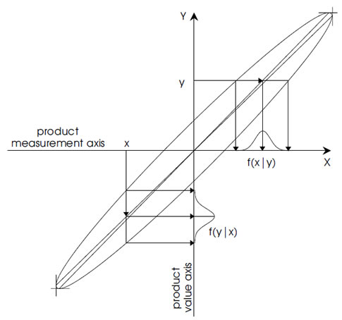

Let’s begin by letting Y denote the value of an item in the product stream. When we measure this item, we will get some observed value. Denote this value by X. The problem of measurement error is that X is seldom the same as Y. Because we have two variables here, we need to use a bivariate probability model. Moreover, because the normal distribution is the classic distribution for measurement error, we shall use a bivariate normal model. Thus, we can place the product values Y along the vertical axis and our observed values X along the horizontal axis. Our bivariate model creates the ellipse in figure 1. The better the measurement system, the thinner the ellipse and the stronger the correlation between the product values and the observations.
Now consider the experiment of measuring the same item repeatedly. The item being measured will have a value of Y = y. This value of Y will define a horizontal slice through the ellipse. The width of that slice will define a range of measurement values that will occur in conjunction with Y = y. The distribution shown on the horizontal axis and labeled f(x| y) defines the conditional probability model for the measurements X given that Y = y. This conditional distribution of X given Y has a mean of:
MEAN(x | y) = y
Thus, the measurements will cluster around the product value. This distribution also has a standard deviation of:
SD(x | y) = σe = standard deviation for measurement error
Figure 1: The bivariate distribution of product values Y and observed values X
The fact that the standard deviation of the conditional distribution of X given Y is the standard deviation of measurement error is the reason that all measurement system studies are built upon repeated measurements of a collection of product samples. However, the distribution of X given Y will not help in answering the question of whether an item is conforming.
When you are standing at the end of the production line holding an item that you have just measured, the question of interest is, “Given this observed value X, is it likely the product value Y is within the specifications?” To answer this question, we begin with a single observed value X = x. This value for X creates a vertical slice through the ellipse and defines a range of product values Y that could have given rise to the observed value X = x. The conditional distribution of Y given that X = x is labeled as f(y|x) and shown on the vertical axis in figure 1. This conditional distribution defines the probability model for this range of values for Y. This distribution is a normal distribution with mean of:

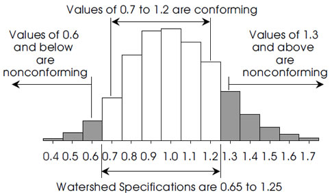

Figure 2: Watershed specifications

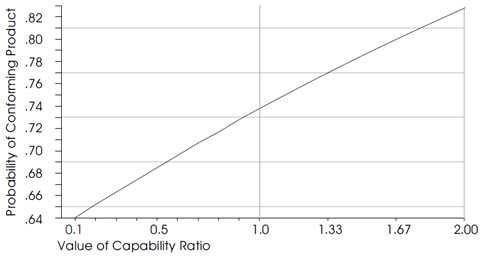

However we define our manufacturing specifications, it should be clear that the most extreme values within them are the ones most likely to represent an item that might be nonconforming. Therefore, we evaluate the different options that follow by looking at the most extreme values for X that fall within the manufacturing specifications. For these values, we evaluate the probability of conforming product using the integral defined above. Of course, these probabilities will vary depending upon the process capabilities. (If that was the point of Ouellette’s article, then he is correct in stating that I did not cover this aspect of the problem in the earlier article. I omitted it for the sake of simplicity.)
If we use the stated specifications as our manufacturing specifications, and if we get an observed value that is either the minimum acceptable value or the maximum acceptable value, and we calculate the probability of conforming product, we will get the curve shown in figure 3 as a function of the process capability.
Figure 3: Minimum probabilities of conforming product using the stated specifications
Thus, without regard for the capability, when you ship using the stated specifications, you can be sure that there is at least a 64-percent chance that the shipped material will be conforming. With a capability of 1.0, this minimum probability goes up to at least 74 percent. With a capability of 2.0, this minimum probability goes up to at least 83 percent. If your customer is happy with these numbers, then guardbanding is not for you. Figure 3 is the basis for saying that the watershed specifications define 64-percent manufacturing specifications.

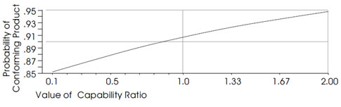

First, I considered what would happen if the watershed specifications were tightened by one probable error. Looking at the most extreme observed values within these tightened limits and calculating the probability of conforming product, we get the curve in figure 4.
Figure 4: Minimum probabilities of conforming product when both specifications are tightened by one probable error
When the watershed specifications are tightened by one probable error on each end, you will have at least an 85-percent chance of conforming product. With a capability of 1.0, this will go up to at least 91 percent. With a capability of 2.0, this will go up to at least 95 percent. Thus, when your manufacturing specifications are the watershed specifications tightened by one probable error, you will have at least an 85-percent chance of conforming product.

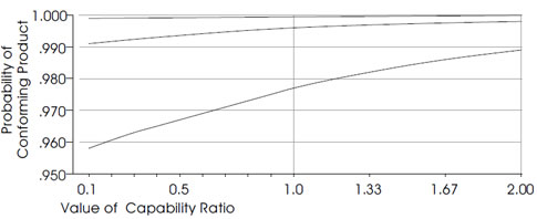

When the watershed specifications are tightened by two probable errors on each end, you will have at least a 96-percent chance of conforming product. With a capability of 1.0, this will go up to at least 97.8 percent. With a capability of 2.0, this will go up to at least 99 percent. This curve is the bottom of the three curves in figure 5. Thus, when your manufacturing specifications are the watershed specifications tightened by two probable errors, you will have at least a 96-percent chance of conforming product.
Figure 5: Minimum probabilities of conforming product when both specifications are tightened by 2, 3, and 4 probable errors
When the watershed specifications are tightened by three probable errors on each end, you will have at least a 99-percent chance of conforming product. With a capability of 1.0, this will go up to at least 99.6 percent. With a capability of 2.0, this will go up to at least 99.8 percent. This curve is the middle of the three curves in figure 5. Thus, when your manufacturing specifications are the watershed specifications tightened by three probable errors, you will have at least a 99-percent chance of conforming product. Notice that three probable errors will be approximately 2σe. rather than the more common, but incorrect, 99-percent guardband value of 3σe.
When the watershed specifications are tightened by four probable errors on each end, you will have at least a 99.9-percent chance of conforming product regardless of your capability. This curve is the top curve in figure 5.

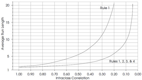

Of course, between the signal attenuation and the inflation of the limits, measurement error will affect the ability of a process behavior chart to detect process changes in a timely manner. The traditional way of characterizing the sensitivity to a signal is to consider the average run length (ARL). (The ARL is the number of subgroups between the point when a signal occurs and the point when it is detected.) Here we look at a process shift equal to three sigma(Y) and consider using the four detection rules of the Western Electric Zone Tests. Figure 6 gives the ARL as a function of the intraclass correlation for different combinations of detection rules. These ARL curves are shown in figure 7.
Figure 6: Average run lengths considering different combinations of detection rules for a three-sigma process shift
These characterizations of how measurement error will affect the ability of a process behavior chart to detect process changes allow us to fully characterize the relative utility of a measurement system for a given application. In doing this we end up with four classes of measurement systems.
When the intraclass correlation is between 1.00 and 0.80, you will have a first-class monitor. Here any signals from the production process will be attenuated by less than 10 percent. Using detection rule one, the ARL for detecting a three-sigma shift will be less than 2.6 subgroups (compared to 2.0 subgroups for a perfect measurement system).
Figure 7: Average run length for a three-sigma process shift
When the intraclass correlation is between 0.80 and 0.50, you will have a Second Class Monitor. Here, any signals from the production process will be attenuated by 10 percent to 30 percent. Using detection rule one, the ARL for detecting a three-sigma shift will be less than 5.5 subgroups. Using detection rules one, two, three, and four, the ARL for detecting a three-sigma shift will be less than 2.7 subgroups.
When the intraclass correlation is between 0.50 and 0.20, you will have a Third Class Monitor. Here, any signals from the production process will be attenuated by 30 percent to 55 percent. Using detection rules one, two, three, and four, the ARL for detecting a three-sigma shift will be less than 5.7 subgroups.
When the intraclass correlation is less than 0.20, you will have a Fourth Class Monitor. Here, the measurement system is on the ropes and should only be used in desperation. Signals from the production process are attenuated by more than 55 percent, and the ability to detect process signals rapidly vanishes as measurement error completely dominates the observations.
