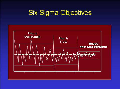

We all agree that variation is good for the makeup of a team, but it can be disastrous from a quality standpoint in the products we are delivering. Six Sigma, as the name implies, was designed to decrease variation in outputs, thereby increasing the probability of shipping error-free products (see figure 1).
Figure 1. Six Sigma objectives |

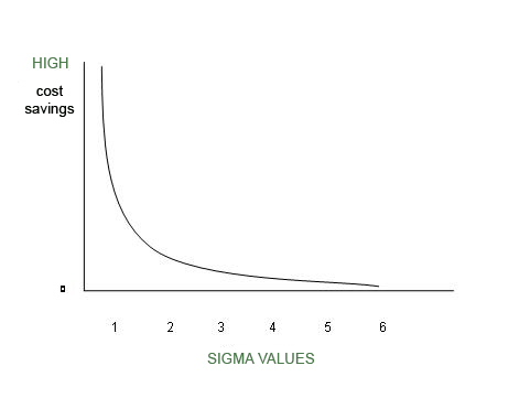

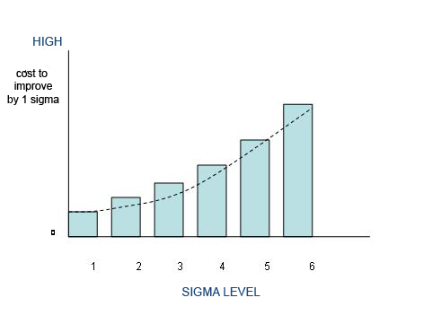

As figure 3 shows, the cost savings for changes in sigma levels becomes a lot smaller and you strive for higher and higher sigma levels. To add to the complexity, the level of difficulty and the associated cost to define and implement the improvement goes up as you define the improvement for higher sigma levels (see figure 4).
Figure 3. Cost saving from moving from one-sigma level to the next sigma level |
Figure 4. Cost to improve from a sigma level to the next sigma level |
In the example we have shown, it’s impractical to improve your process past the three-sigma level based on a pure cost analysis, because the maximum cost savings in moving to a four-sigma level is $264.
