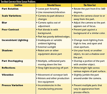

With so many vision sensors available today, it can be a daunting task to figure out which one is right for your particular application. Will the product you're evaluating handle the variable conditions that exist in your plant? What are the latest networking capabilities to look for? What types of accessories and product support options are important?
Whether you're brand new to machine vision or an experienced user, this guide will help you during your vision sensor selection process. It provides answers to 10 of the most important questions to consider, and offers valuable tips on how to evaluate specific product features.
1. What is the importance of part location tools, and how can I assess their performance?
Part location tools, available with virtually all vision sensors, are software programs used to find parts within the vision camera's field of view. This is typically the first step in any vision application--from the simplest robot pick-and-place operation to the most complex assembly verification task--and the one that usually determines whether the application succeeds or fails.
It sounds simple enough, but locating parts in today's production environments can be extremely challenging for vision sensors. This is because many variable conditions exist that can alter the way a part appears to a vision sensor, which is trained to recognize parts based on a reference or "model" image of the part. Variable conditions include part rotation, changes in optical scale, inconsistent lighting conditions and normal variations in part appearance.

The Ten Most Common Vision System Problems
