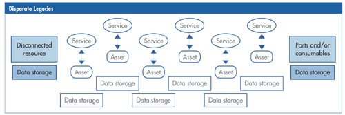

Shifting focus from task to asset
Although most legacy software systems on the factory floor focus on repair, changeover or calibration, it's important to remember that an "asset" is the core element, and service and support tasks are merely activities or events that contribute to documenting the overall cost of ownership, system governance, maintenance and compliance programs.
Companies invest millions of dollars in assets for production facilities, including manufacturing machinery, test equipment and human capital. Consolidating real-time and historical
service data from the disparate software systems that manage assets can help optimize an organization's potential in the following ways:

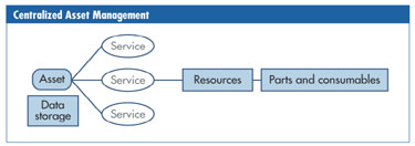

For example, if a specification or work instruction is required to perform a task within one system, it shouldn't require re-entry or manual cut-and-paste to another application database to make it visible to that application. Common procedures and specifications should reside in one place and be available to all other applications that need that same data. Cost savings can be realized by eliminating redundant data-entry operations as well as by increasing data reliability.
By consolidating redundant information and selecting software systems that track activity-based costs around the asset itself rather than the type of work being performed, an organization will increase cost-reduction opportunities across multiple disciplines in the asset-management process. The company might actually reduce the number of software applications, databases and administrative resources required to maintain a healthy asset program.
From a software-technology perspective, the process required to keep tactical assets of any type available and functioning are basically the same, regardless of the type of service or support activity being performed. The process includes:
Identifying the physical asset that requires service activity
Specifying the activity to be performed and who shall perform it
Providing the task-specific information required for success
Providing necessary supplies and/or equipment
Managing the information and/or resources during the process
Documenting the process and assessing related effects
Analyzing opportunities to prevent negative recurrences
The more asset life-cycle data are centralized and made available to all support personnel, the more efficiently they can assess a situation and execute their duties based on facts. This results in a positive, cost-effective outcome.
Lab and calibration systems, for example, don't always have access to preventive maintenance or line-changeover schedules. The lack of manufacturing visibility to the calibration lab prevents it from easily synchronizing calibration schedules to minimize equipment downtime and avoid duplicate or redundant effort for activities that could have been scheduled concurrently.
When internal facilities operate as suppliers or customers of one another, it's good business to synchronize preventive downtime across facilities to avoid soft spots in production performance that could affect other facilities' production capability, delivery and profitability.
