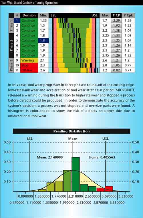

MICRONITE uses three types of predictive models: nonlinear trend control, control of probability of defects and control of extent of tool wear. Because sampling time is critical, adaptive intervals for every tool are updated after each data entry. The system also allows predetermined levels of product variation. Real-time control by a CpK model (without using X-bar and R charts) guarantees a customer-required variation index.
How does it work?
A workstation is located near a machine, a group of machines or a cell. Upper and lower specification limits are entered for each dimension, as is the cycle time for each cutting operation. Based on the tool-wear model, the number of parts run and other parameters, the software prompts the user to measure a unit or sample. The software then tells the operator to continue, input a compensation adjustment into the machine or change the tool. It will also tell the operator how long before the next measurement must be taken. The software adapts the model as new data is collected and analyzed.
Here's an oversimplified description of what actually occurs. First, a process (i.e., tool wear) curve is segmented in real time by one of iPACT's rule-based models. After every data entry (either sample or unit), a model predicts the risk of defects until the next inspection, the rate of tool wear related to the location of data averages, and sample variation. If the system determines that a risk of defects has increased, a compensation adjustment will be recommended; if tool-wear rate has dangerously increased, a tool change is advised (See figure).
A trend control model will stop a process at the point of accelerating tool wear and increased risk of defects. A model controlling the extent of tool wear will stop a process before severe tool deterioration occurs. Stable processes with relatively low tool-wear rates are controlled by separate estimates of the probability of defects on the lower and upper specification limits. Sampling time is critical and is adjusted dynamically after each measurement; a stable process with little variation would require a longer sampling interval than a process with large variation and high-rate tool wear.
When a tool is indexed, sharpened or changed, you can't expect duplication of a process curve; all tool-wear processes are nonrepetitive. This means that all parameters, such as sample variation, tool-wear slopes, rate of tool-wear acceleration and a number of mini-processes, will probably change. Therefore, a new model is needed in order to control a new process. Whenever the user indicates a process change, iPACT will start a new modeling cycle. Only when mature and long-running processes repeat will iPACT use historical data and statistical process control for process control decisions.
Predictive trending and adaptive sampling intervals ensure that a machine is operated to its maximum capacity. Tools achieve maximum usage before change-out, and sampling is performed only when needed. Both of these decrease waste and increase machine uptime and operator efficiency.
