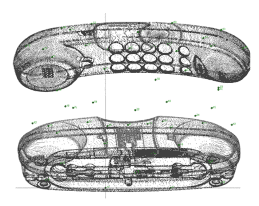

This scenario utilizes capabilities within the scanning system to provide a global common reference for all components in the assembly. A simple and effective example of this process is conveyed with a desktop phone. In this scenario, the scanning system will be used to capture the 3-D "as manufactured" representation of the handset and base unit, and it will also generate a global reference coordinate position file that provides the location and positional orientation of each component. (See image below.)
A 3-D scan of telephone handset (top) is combined with a scan
of the base unit to produce an "as assembled" model.
To do this, adhesive or magnetic circular markers--i.e. targets--are applied to the assembled components. These targets, when identified by the software, serve two purposes. They provide location and positional coordinates as to how the handset and the base unit fit together, as well as support the automatic scan-to-scan patch alignment during the scanning process (i.e., adjacent area scans are accurately stitched together in software). The dual-camera scanner has a "find reference points" function that quickly and automatically identifies these markers via an automated ellipse-finding algorithm. The result is a global reference file that contains the x , y and z coordinate values for the center point of each marker, a unique identification number for each marker, and the relationship of all markers to one another.

Once the "as assembled" reference file has been obtained, the scanning begins. The handset is taken off the base unit and completely scanned independent from the base unit. Each scan is automatically transformed into its correct location based on automatic identification of the targets seen in that scan. The same scanning process is performed on the base unit. The result is two separate scan models that have a common coordinate position, so if they're opened in the software or in CAD, finite element analysis (FEA) or manufacturing package, they will appear in the "as assembled" position.
This "as assembled" digital definition can then be interrogated for form, fit and function purposes.

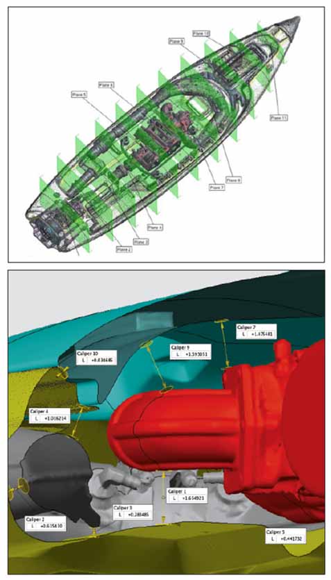

A valuable benefit of a digital assembly is the ability to extract dimensional data in those areas not accessible after the components are assembled. Cutting or sectional planes can be placed at will and dimensions extracted. If there is a CAD assembly model, the software can perform an "as built" assembly comparison and generate cross-sectional "hair plots" displaying the dimensional differences as shown in the images on page 29.
With digital assembly it is possible to look at cross sections of an assembly (top)
and then examine clearances on the "as assembled" model.
Because safety and floatation capabilities of the surfboard are paramount, being able to digitally examine cross sections of the "as assembled" surfboard not only enabled Montgomery and his team to identify possible clearance issues, but also to maximize the amount of foam used in the board's construction so that it exceeds the floatation requirements of the U.S. Coast Guard.
"This is such a valuable tool for us," explains Montgomery. "You have to consider clearances. You have to consider the hydrodynamics of the craft. And you still have to make everything fit. Every quarter-inch is needed. The performance is based on everything being as small and light as possible."
