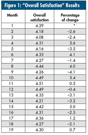

I once did some work for a medical center that had, at every one of its 20-plus clinics, a table with a sign stating, “Tell Us How Your Visit Was.” As patients left the clinic, if they chose, they could take the opportunity to rank the medical center on a one-to-five (worst to best) basis in nine categories.
The cards were collected at the end of each month, sent to an outside firm for objective processing (a serious expense), and the monthly stats were then given to the clinic administrators, who were held accountable for the results. Any clinic with a 3-percent or larger drop from the previous month had to explain why and subsequently submit an action plan for improving the score the next month.

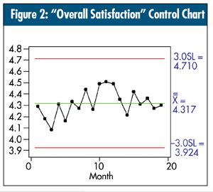

Figure 1 shows one clinic’s “overall satisfaction” results for 19 months, and figure 2 shows the resulting control chart, which the outside firm didn’t supply. It only compared the current month with the previous month and looked for “short-term trends.”
Using standard control charts calculations (with median moving range), one month could differ from its preceding month by as much as 0.48, or 11 percent of the mean. Notice that all data lie within the limits of 3.92 to 4.71. This is a stable process--for people who choose to fill out surveys... which is what percent of patients?
Think about it. Why should anything have changed? The current process treats common cause as special cause, i.e., processing a biased sample of data and exhorting people to improve based on arbitrary interpretations.
