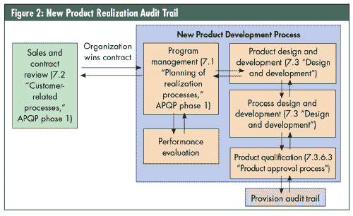

New product development (NPD)
The success of the new product development process is vital to the future of the organization being audited. This process is ineffective in many organizations and often leads to problems with timing, product quality at launch and designs that don’t meet customer expectations.
As seen in the flowchart in figure 2, the audit trail starts by identifying customer-related processes or sales processes (subclause 7.2), then proceeds to program planning, design and development of the product (subclause 7.3), process or technology development and, finally, to the production part approval process (PPAP). In some industries, such as semiconductor design, technology development occurs first. The entire set of advanced product quality planning (APQP) requirements can be audited only when technology and product are being developed initially.
After the PPAP, the audit moves to the operations, process monitoring and improvement audit trails.
The links in this audit trail are those from contract review (subclause 7.2) to the product approval process. To audit this trail, the auditor first selects product samples and tests customer-related processes or sales processes (subclause 7.2) for the contract review. This will verify that the organization has properly identified and reviewed the product requirements prior to agreeing to supply the product. Contract review is a sales and marketing function. To ensure that there’s a trail to product planning and then to the plant, the auditor identifies the products that have recently been through the PPAP or are being produced in the plant.
Next, the auditor examines how the organization has planned the processes required to produce the product identified in product-realization planning (subclause 7.1). This audit of process planning takes place where the organization conducts its project or program management. During this phase, or early in the audit trail, the auditor should document the goals and objectives of the product launch. What were the timing, quality goals and budget at the start of the program? Those in the organization who were involved with program or project management should be able to identify where they started and what the results were. If they can’t, that’s a finding in the audit.
For a product launched a few months to a year before, the organization should provide the auditor with the quality history or scrap, rework and customer rejects data. It’s important that the auditor conducts this performance evaluation and subsequently prioritizes the audit areas. He or she then tracks a sample product through design and development (subclause 7.3) to test that each step of the new product and process development procedure has been followed. Finally, the product approval process is reviewed for content and effectiveness.
It’s always good to sample a variety of products, including those that have been running for one year, those that were recently introduced and those still in the pipeline. The auditor should try to audit each of these and many others chosen randomly when auditing customer-related processes (subclause 7.2). In this way, contracts that were won and lost will be audited. The auditor can study how customer requirements for a particular product were gathered by the organization, as required in subclause 7.2.
The audit scope and product definition are important on this audit trail because a product could include hardware, software, service and processed material. The auditor should carefully define the scope ahead of time.

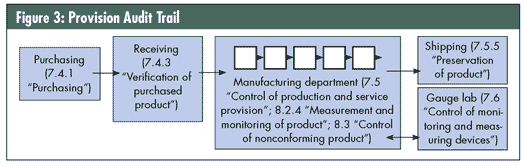

As seen in the flowchart in figure 3, the provision audit trail covers all the activities necessary to produce and deliver products and services to the customer. It includes activities for operating the realization processes, identifying and tracing products and services, handling customer property, preserving product, measuring product and service output, and handling nonconforming product.
The auditor must carefully study the different processes in the organization for production and service provision (subclause 7.5) and sample them appropriately. For example, in a manufacturing plant that has heat-treating, machining, paint and assembly, each of these processes should be sampled.
This audit trail starts with production and service provision (subclause 7.5), then tracks through all the other processes in operations. The auditor studies how processes that produce and deliver the product are controlled, identified, measured and monitored. Customer requirements and characteristics are important during this step of the audit trail. Nonconforming products are segregated and evaluated for disposition. Finally, the performance of the process is analyzed, and projects are chosen for improvement.

The measurement and monitoring devices specified in the control plan must be controlled according to subclause 7.5.1.1. These devices measure the characteristics in the monitoring and measuring of product (subclause 8.2.4). The auditor should document several monitoring and measuring devices when auditing the production and service provision (subclause 7.5), and then follow-up in control of monitoring and measuring devices (subclause 7.6).
Subclauses 7.5.1.1 and 8.2.4 are linked because the former describes the characteristics and the latter measures them. Also, the control plan describes the process for control, and subclause 8.2.4 is the mechanism of that control. Another link is between subclause 8.2.4, which could measure received products, and subclause 7.4, regarding purchasing, which controls supplier processes.
Finally, after product characteristics are measured in subclause 8.2.4, flawless products go to the next stage, and flawed ones are segregated as nonconforming products. These must follow a process described in subclause 8.3, which is concerned with the control of nonconforming product.
The same product sampled in monitoring and measurement of product (subclause 8.2.4) and control of nonconforming product (subclause 8.3) is analyzed with other organizational data in the analysis of data (subclause 8.4), and further developed in the improvement (subclause 8.5) phases.
