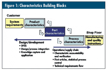

It’s been observed that characteristic understanding is to product definition as atoms are to physics. A product is the sum of the dimensions, geometries, notes, and specification references that define what it is, how it will perform, how it must be made, and how it will fit with the next-higher assembly. Depending on the product, characteristics might go beyond physical attributes to include such things as input/output relationships. Characteristics are discretely measurable and comprise the building blocks that create product features. If a hole is a feature, the diameter, depth, and surface finish of the hole are its characteristics. Individual part characteristics are the center point where design intent and process capability come together. They form the bridge between abstract design and tangible hardware.
As the illustration in figure 1, below, shows, a discrete part’s characteristics are determined by its relationship to the larger product, which is the result of the overall system requirements. Converting these part characteristics into a real part is a factor of how capable the selected processes are in efficiently making this conversion. Starting with the part and its characteristics, it’s possible to look upstream at the design/development process and downstream at the operations/supply chain process. The upstream process is one of knowledge capture and application; the downstream process is one of knowledge execution. Both are dependent on a clear understanding of characteristics and their relationships to design requirements and process capability, coupled with a disciplined approach to making those relationships work. Each has a set of emerging approaches that, when applied, will substantially improve product integrity.

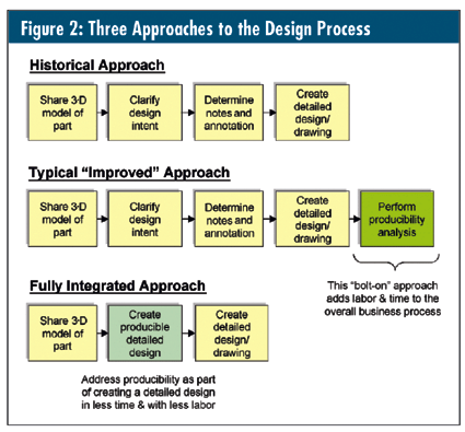

Making all this happen at the part level requires discipline and commitment to the process, but it’s sometimes missing even in the model-based enterprise. Bringing manufacturing engineers into the design process is a popular approach. However, it’s where and when they enter the process that determines their effectiveness. The historical tendency to “throw the design over the wall” has clearly lost favor. The more recent--and more enlightened--approach provides for a producibility assessment (often near the end of the design process) as a bolt-on activity during an obligatory tollgate review. This method has limitations because the manufacturing input often means changes to the design, which in effect creates “rework” for the design engineer. The bolt-on approach, although better than no manufacturing input, doesn’t represent a truly integral and collaborative exchange process. Making the manufacturing engineer integral to the process is clearly the best approach, but it’s also challenging--both culturally and technically. The illustration in figure 2, below, highlights the three approaches.
Overcoming the cultural hurdle of making manufacturing an integral partner to design is only the first step. Even if the process allows for the manufacturing engineer to be at the design engineer’s side from the beginning, resource limitations make this impractical. However, by merging the best of the MBE’s technical promise with an enlightened design process, the three factors of knowledge capture and reuse, application, and exchange can come together seamlessly at the component part level. The enabling technology for this merger is beginning to emerge as new software products become available.
Such a software product can serve as the technical platform for integrating process knowledge and design practices, and can also provide component part characteristic- level DFMA--with an emphasis on the “M”--in an model-based enterprise. Ideally, such a system is “CAD neutral,” allowing the manufacturing engineer to receive, evaluate, and annotate a solid model image during that dynamic period when a part approaches detailed design, but before it’s too late to make meaningful suggestions. Using the combined design and manufacturing knowledge, the system can both store and dispense essential process insights, specification references that apply to individual processes, and design constraints. It then enables the application of this knowledge as direct characteristic-level annotations to the model. These annotations are then systematically captured in a “bill of characteristics” that allows them to be managed going forward throughout the product life cycle.
One such system, known as DISCUS Design, has been applied in some pilot applications. During these initial applications, it demonstrated increased engineering productivity, shorter cycles, and designs that are ready for transition and affordable production. By bringing together best practices in both the technological and cultural aspects of product development, such a system offers a practical approach to DFSS, with results that support the goals of product integrity.
