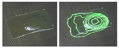

• Topographic display. A large carbon composite panel is scanned and compared to CAD design specifications. The measurement indicates a raised area, or deformity, in the panel. The system projects a topographical representation of the variation onto the piece, allowing fabricators to see the precise outline and magnitude of the deformity, as seen in the images below. The piece is immediately marked and sent to rework.
