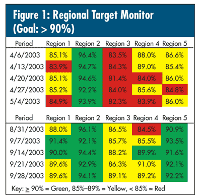

If you need further proof that government agencies can keep meticulous track of the unnecessary, take a look at the data in figure 1. This chart was sent to a government agency every week for monitoring an arbitrary target that had been set. There were 28 regions; for the sake of brevity, I've chosen five of them and given the first and last five weeks of data so you'll have an idea of what was presented at the meetings—for this particular week, a 26-by-28 matrix of numbers—and what received a reaction (no doubt with "little circles").

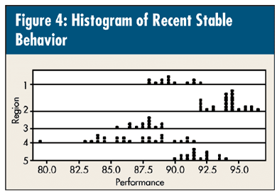

Note the difference of the histogram in figure 2 with the one in figure 4 that uses the most recent stable history (region 1—last 13 observations; region 2—all the data; region 3—last 13 observations; region 4—all the data; and region 5—last 13 observations). This, along with the control-chart analysis in figure 3, provides an excellent summary. The graphs say it all. By the way, did you notice that region 4's variation is approximately 2.5 times greater that of the other regions?
