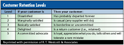

ISO 9004 emphasizes customer satisfaction. It focuses on how the quality policy embraces customer needs and expectations and how an organization can interpret their relevance. The guideline also addresses the resources and processes that will satisfy customer needs and expectations, and outlines how to collect and analyze the data. Thus, the guideline addresses factors that lead to customer retention and refer your organization to potential customers. Consider the five scenarios:

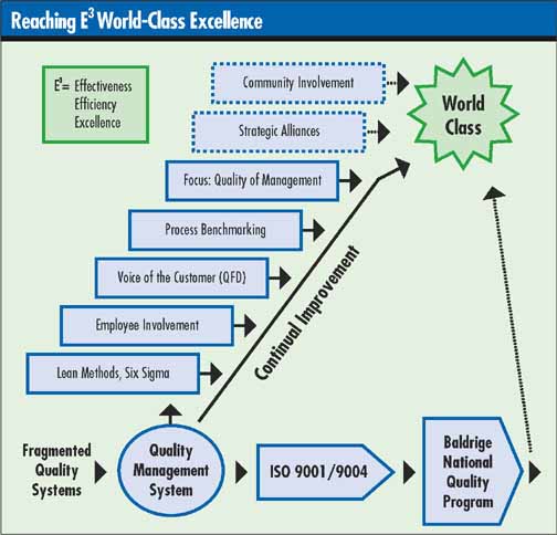

A value-adding QMS is a necessity for survival for all types of organizations. The most efficient way of establishing one is by using the guidelines outlined in ISO 9004. Companies should build an ISO 9001-based QMS and then expand to broader Baldrige-type criteria to achieve E3 status (as illustrated above):
ISO 9001 for effectiveness
ISO 9001:9004 for efficiency
ISO 9001:9004 plus applicable Baldrige criteria for excellence
