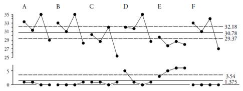

The measurement system consists of a manual test stand that measures an electromagnetic property of particular product. Because this manual test stand is used in production for 100-percent inspection, it is crucial to the operation of the plant. Since six operators routinely perform this test, all six were included in the EMP study. The four parts used in the study were selected from the product stream on each of four different days.
With simple and objective measurement systems the EMP study may be performed in a fairly straightforward manner. Richard Lyday would usually collect his data in two or three rounds where each operator would measure each part once in each round. However, with subjective or complex measurements it may be necessary to “blind” the experiment so that the operators do not know when they are retesting a given item, and where the order of testing is shuffled or “randomized” in some manner.
Figure 1:  EMP study for the manual test stand
The key to understanding any average and range chart is to understand what sources of variation are found within the subgroups and what sources of variation are found between the subgroups. In figure 1, there are three distinct sources of variation: the operator-to-operator and part-to-part differences that show up between the subgroups, and the measurement-to-measurement differences that show up within the subgroups.
The test-retest variation found within the subgroups is commonly known as the repeatability. This isolation of the test-retest error within the subgroups, with all of the other sources of variation showing up between the subgroups, is the distinguishing characteristic of an EMP study. Because of this isolation of test-retest error, the limits shown on the average and range chart in figure 1 depend solely on the test-retest error. Therefore, the limits in figure 1 specifically show that amount of variation which can be attributed to measurement error alone.
As always, the average chart looks for differences between the subgroups, while the range chart checks for consistency within the subgroups. This characteristic of the charts means that the range chart in figure 1 checks these 24 subgroups to see if there is any inconsistency in the amount of test-retest error shown. The range values that fall above the upper range limit are signals of inconsistency in the test-retest error. Since such inconsistencies represent serious problems with the measurement procedure itself, the causes of these points deserve investigation.
Because the limits for an average and range chart are robust, we can, in spite of the inconsistency on the range chart, also use the average chart to evaluate the part-to-part and operator-to-operator differences. We begin by discussing the part to part variation.

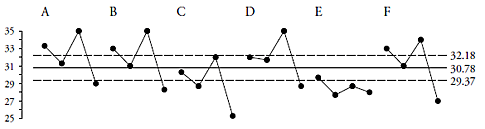

The differences between the parts will depend on how the parts were selected. Sometimes the parts may be selected at specific intervals from the product stream. At other times the parts may be a simple grab sample, or some other type of haphazard sample, selected from the product stream. And in some cases the parts may be deliberately selected to represent a range of product values. Regardless of how the parts are selected, you will want to detect the part-to-part differences in spite of the uncertainties introduced by measurement error. This means that you will want to find points outside the limits on the average chart. As long as you did not select the parts in such a way that they all end up being alike (such as what might happen if you use only rejected parts in the study), you will expect to find points outside the limits. The average chart allows us to make a visual comparison between the part-to-part variation and measurement error. The part-to-part variation is represented by the width of the band swept out by the running record. The measurement error is represented by the width of the average chart limits. Thus, the wider the band swept out by the running record is relative to the width of the limits, the easier it will be to detect product variation in spite of measurement error.

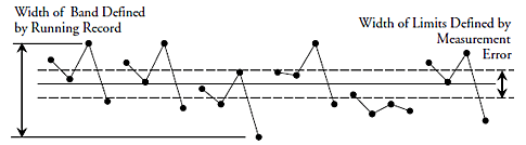

Figure 2:  Relative utility of measurement system shown on average chart
At the same time that we want to detect the part-to-part differences, we prefer for there to be no differences between the operators. There are two ways to check for operator differences using the average chart. The first of these uses the shapes of the running records, and the second uses the positions of the running records. In order to facilitate both of these comparisons, an EMP study will omit the line segments that would connect dots from one operator to the next.
To see how to interpret the shape of the running record, it is helpful to begin by considering what the average chart would look like if there were no differences between operators and also no measurement error. Under these conditions the running records for each operator would be exactly the same.  Segment by segment they would be perfectly parallel to each other (rather like the curves for Operators A and B). However, as soon as we introduce measurement error into the picture, we will begin to see slight departures from perfect parallelism (rather like the curves for Operators D and F). As long as there is a reasonable degree of parallelism, we need not be concerned. Here Operators A, B, C, D, and F all show a reasonable degree of parallelism.  Operator E, on the other hand, displays a serious lack of parallelism.
Figure 3: Lack of parallelism for Operator E
So what does a lack of parallelism represent? Serious nonparallelism is indicative of an interaction effect between the operators and the parts. (Algebraically, interaction effects and nonparallelism are one and the same thing: You cannot have an interaction effect without a lack of parallelism, and vice versa.) Here we see that Operator E is measuring these four parts in a substantially different manner. Since there should be no interaction effects between the operators and the parts, this interaction represents a serious inconsistency in the measurement process that needs immediate attention. Such interaction effects might be due to operators using different techniques, or to some operators skipping a step in the measurement procedure, or simply due to the presence of one or more untrained operators. But whatever the cause, it is a problem with the measurement process that needs to be fixed.
In addition to checking for parallelism, we can also compare the positions of the running records.  When we do this we are essentially comparing the operator averages. In figure 4 we see that both Operator C and Operator E have averages that are substantially lower than those of the other four operators.  Such differences between operator averages are potential operator biases.
Figure 4:  Potential operator biases for Operators C and E
So, what can we say is the overall message of the EMP chart in figure 4?  Operators A, B, and F show good parallelism, have similar averages for these four parts, and show consistently small amounts of test-retest error. Comparing the width of the limits with these three running records, we can see that the manual test stand can detect product variation.
Operator C shows good parallelism, and a small amount of test-retest error, but he is consistently low on all of his measurements. This is a potential operator bias. The reason for this bias needs to be identified so that the bias can be eliminated.
Operator D has reasonable parallelism and a good average, but she has a range point above the upper limit of the range chart. Obviously one of her readings for Part 1 is problematic. Although the other ranges and the reasonable parallelism show that she usually does a good job, the reason for this aberrant reading needs to be identified.
Operator E has large ranges, poor parallelism, and the wrong average for these four parts. Whatever else you might say about him, he clearly does not know how to use the manual test stand. While Operators C and D may need a refresher on using the test stand, Operator E needs to be moved to another job until he can be trained in how to use this device and can display a skill level comparable to that displayed by the other operators.

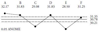

Main effect charts
To compare the operator averages, we use an analysis of main effects (ANOME). This is a generalization of an average chart that is appropriate for experimental studies (which will have a fixed amount of data). The limits will be computed using the grand average and the average range from figure 1. In an ANOME the original k subgroups of size n are rearranged into m subgroups, and the idea is to see if any of these m subgroup averages are detectably different from the grand average. The limits for the main effect chart will be:
where ANOME.05 is the 5-percent critical value for an analysis of main effects. This critical value will depend upon n, k, and m, and may be found in the table in figure 5.
Figure 5: Scaling factors for main effect charts
For the data from figure 1, the six operator averages are 32.17, 31.83, 29.08, 31.83, 28.50, and 31.50. The grand average is 30.78 and the average range is 1.375. With n = 3, k = 24, and m = 6, our scaling factor from the table in figure 5 is ANOME.05 =  0.415, resulting in limits of:
The main effect chart in figure 6 shows Operators A, B, and D to have averages that are detectably greater than the grand average, while Operators C and E have averages that are detectably lower than the grand average. Since the grand average is a somewhat arbitrary point of comparison, we can look at the width of the limits and conclude that Operators A, B, D, and F have reasonably similar averages, while Operators C and E have averages that are substantially different from the other operators.
Figure 6:  Main effect chart for manual test stand data
Hence, figure 6 shows that the apparent operator bias seen in figure 4 is real. When you are presenting the results of an EMP study, the use of a main effect chart will make any operator biases easier to see.  Moreover, it will make it much harder to dismiss real operator biases as a fluke.
