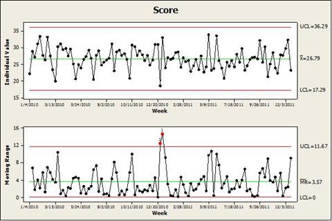

One specific situation sparked my would-be presentation. I was consulting with a large company, working with one of their business units in the role of a Six Sigma Master Black Belt. As a result, I was invited to many management meetings. One regular Thursday meeting concerned a metric that management cared about deeply. Each week, one manager who “tracked” this metric would show the dashboard, then present some conjecture on why the metric was either above the target or below it. If they were above the target, the director would congratulate everyone; thank them for all their hard work. If they were below, the director would ask where everyone thought the problem might be. Usual red-green stuff. The dashboard essentially looked like this:
As it happened, most of these same people also came to a Friday meeting that I had some responsibility for. I had asked for the historical data, and so each Friday, I presented an individuals and moving range chart of these data.
You could even do a capability study with these data, using the target of 28 as a lower specification limit:
Now, anyone who understands the lesson of the red bead knows—with just a casual glance at the process behavior chart—that this process will produce many weeks above the target. They also know, though, that it’s going to produce even more weeks below the target. The metric has been essentially stable for two years, with the centerline just about straddling the target (but just below). The capability study predicts that they’ll be below target about 65 weeks out of 100. The one assignable cause in the moving range chart was due to an exceptionally low week during the Christmas holidays.
So, every Thursday, we’d see the red or green, and we’d pass out wrist-slaps or T-shirts. During red weeks, there would be some furious activity to find out what happened, and take some swift action to tamper with the system. During green weeks, everyone rested on their laurels. So, at least during green weeks, no one was trying to make things worse!
Then, the next day each week, I’d present the latest process behavior chart and capability study. I’d point out that the company was still in statistical control, and that the average was still below the target line. I’d show the capability study and explain that the numbers there predicted that in any given year the company could expect to be below target more than six weeks out of every 10. I’d tell them that things were going to stay this way until someone decided to actually work on the system of causes that was driving the metric. I was usually met by polite silence, with the director eventually saying, “Thanks for that, Rip... anyone have anything else?”
Finally, one brave soul spoke up and said, “Wait a minute. Are you saying that all this stuff we’ve been doing hasn’t helped? We haven’t improved at all?” That opened the floodgates. By the end of that meeting, management had decided to charter a project to look at the overall system and learn what would have to change to move the lower control limit above the target. I was invited to present the control chart each week at the metric meeting (and to the director’s vice president).
