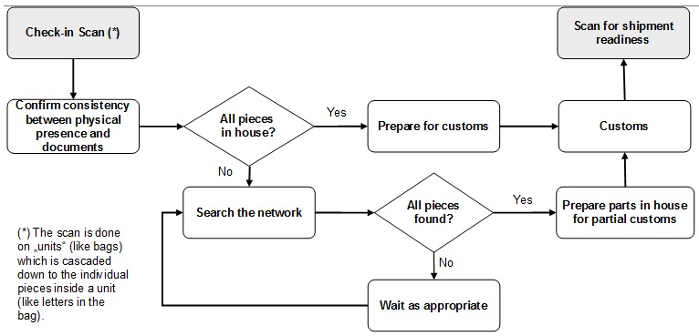

To increase the chances of success, the team decided to follow the define, measure, analyze, improve, and control (DMAIC) methodology. They found the measure phase labor-intensive, particularly as the team worked to create a process map based on observation and interviews. When watching people perform operations in front of computer screens, the team saw them skillfully navigate between various databases, the Internet, Excel files, and other documents. However, because the team didn’t have the specific process knowledge of the area, team members weren’t able to understand the tasks these people were actually performing.
For example, during interviews they learned people needed to open database A to find the number of pieces as per scan results from the check-in procedure. Workers then went to database B and checked the number of pieces listed there. When the two didn't match, a search was performed in database C or, depending on the type of shipment, in an Internet application. Only after persistent questioning did the team understand that these tasks belonged together to form the process step of “checking the consistency between physical presence of pieces and what is reported in the corresponding (and often electronic) documents.” After half a day of interviewing, and drawing and redrawing process maps, the team ended up with the process map as shown in figure 1. All who had contributed agreed this was the process underlying the tasks being performed, but none had actually seen it this way before. In fact, people had just “learned to see” the process they were all working in.
Figure 1 : Process flow in the office

From a value-stream analysis and based on the time-stamp data, the following improvement potentials became obvious:
• For a given shipment, align the process steps currently executed in disconnected “process islands” so that one step is performed right after the next. Ideally, implement “single piece flow.”
• Speed up the handing over to and from customs (an external party) so there is also no waiting
• Eliminate the “wait as appropriate/search the network” loop
