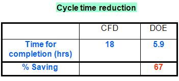

In effect, standalone CFD has taken 23 iterations and 18 hrs, where as optimization using a combination of DOE and Monte Carlo has taken eight iterations and 5.9 hrs.

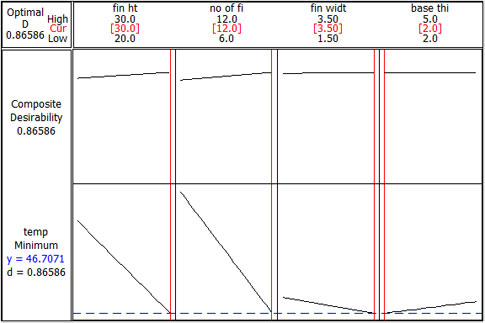

Step 3: Study the Main effects and Interaction plots.

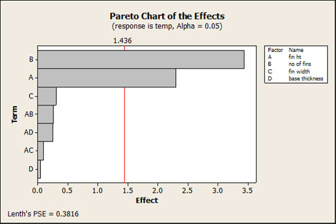

Step 4: Analyze the Pareto plot to estimate the contribution of each of the factors toward the end result.

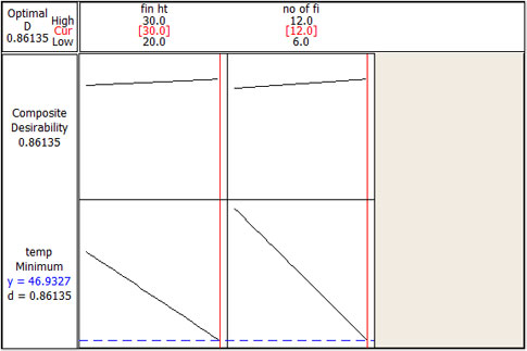

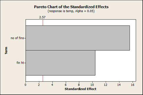

Step 5: Refine the analysis further to eliminate the uninfluential factors, and then study the effects of the two main contributing factors (i.e., fin height and number of fins).
The complete optimization took eight iterations and 5.9 hours.
If you carry out another CFD iteration with the levels as suggested by DOE for the above-mentioned factors, the results will be within 2-percent deviation with respect to the optimized CFD results. This is carried out mainly to fine-tune the model.

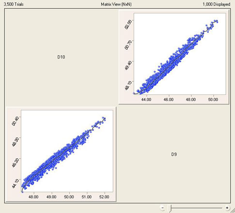

Step 2: The forecasting factors are the transfer function or the regression equation generated out of the DOE runs, both for the four factors and the optimized two factors.

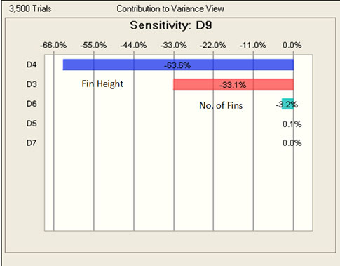

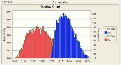

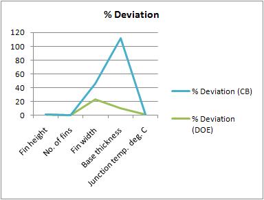

Step 3: The sensitivity analysis of the data reveals the same factors as suggested by DOE. The correlation and overlay plots are in sync as shown below.

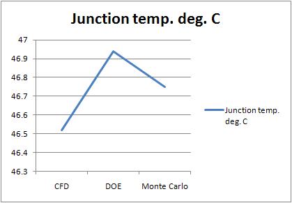

Step 4: Refine the model further by using the levels of the factors as suggested by the Monte Carlo iterations, and run an additional iteration in CFD. The optimized result of junction temperature will be much closer to the original value that was obtained from the former CFD analysis without using DOE.
Step 5: Study the percentage deviation of the various factors with respect to the DOE and Monte Carlo analysis. The values of the significant factors are in line with the DOE results.
