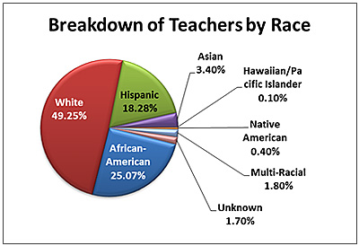

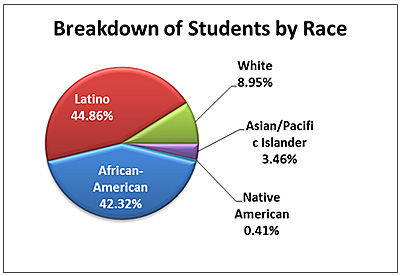

The Office of Procurement and Contracts at CPS supports the material sourcing needs for more than 680 schools throughout 234 square miles. With more than 40,000 full-time employees serving 404,000 students, the number of purchasers and the complexity and variety of items is immense. The highly variable socio-economic circumstances increase the diversity of procurement needs as well.
Figure 1: Diversity of students at Chicago Public Schools district
Figure 2: Diversity of teaching staff at Chicago Public Schools district
Demands on buyers
The diversity factors increase the workload for the Office of Procurement and Contracts. For example, its staff helps would-be purchasers (end users) to create solicitation documents that will accurately fill their needs and efficiently draw responses from qualified suppliers with competitive pricing. A trained and experienced team is needed to support the 40,000 CPS employees with such a complex activity as preparing the solicitation phase of the procurement process. This support can be extremely difficult, if not impractical, to provide when a process is ad hoc and lacks planning.

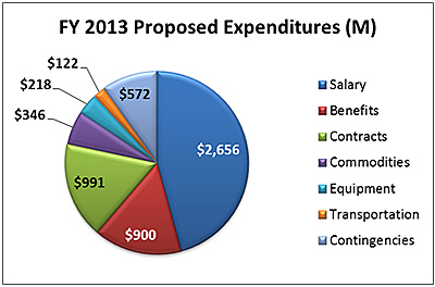

The fiscal year (FY) 2013 budget for CPS was $5.8 billion with seven proposed expenditure categories (shown in figure 3).
Figure 3: Chicago Public Schools district’s proposed budget for FY 2013
Contracts are the second largest component in the school district’s budget (nearly 16%). Furthermore, the FY 2014 budget is projected to have a $1 billion shortfall in supporting revenue. Given these facts, improving the procurement process may be a significant means of realizing cost savings to help reduce the projected FY 2014 deficit.

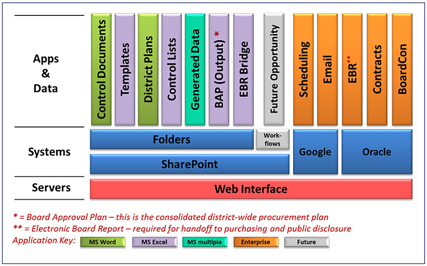

Constraints
A main constraint on this project was the requirement to implement all changes using existing enterprise software. No IT funding was available. The new process had to tie into existing enterprise resource planning applications without any modification to them. This was a significant challenge for implementing an effective districtwide planning process. Because the existing procurement process used a custom Oracle application—the Electronic Board Report operating on a per-item basis—the new process could not be integrated without IT support. A bridging process from the output of the procurement cycle to the input of the purchasing activities had to be developed.
This highlights how critical it is to assess the impact of constraints early in the project planning: to plan for the design and implementation approach and to correctly assess the overall efficiency gains.
Figure 4: Making use of existing applications. Click here for larger image.

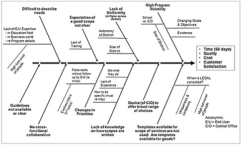

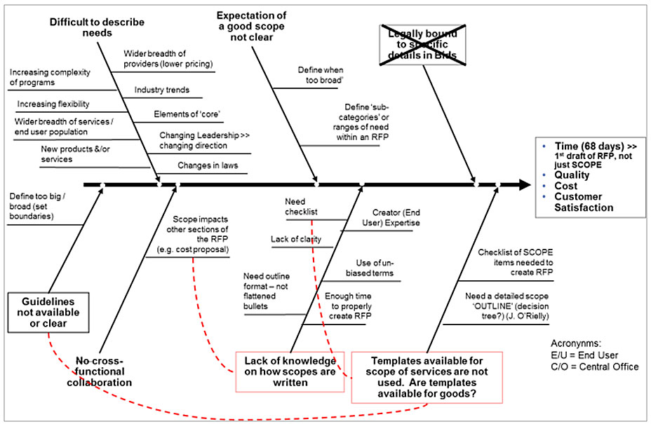

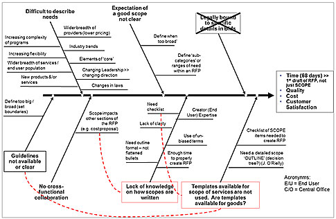

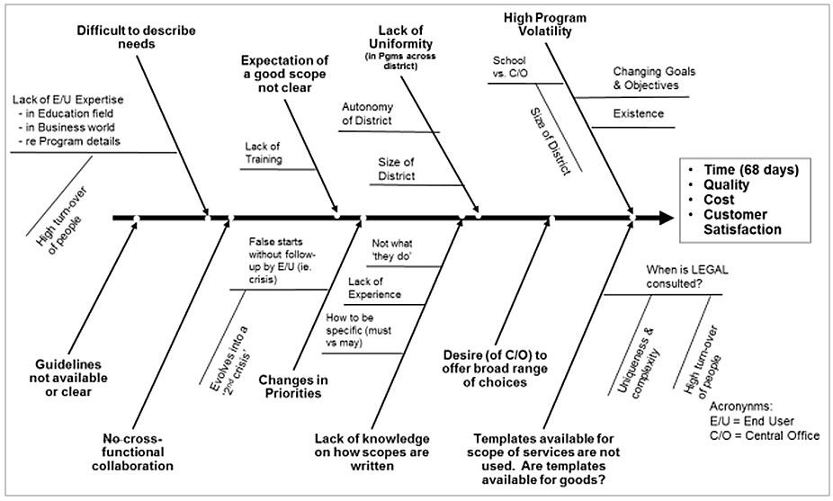

Fishbone diagrams. One of the key process deliverables with the greatest amount of rework was creating the scope of goods and services for the supplier solicitation document. Two brainstorming sessions were held to better understand the root causes. The first session was held with appropriate staff from the procurement and legal departments; the second included staff from buyers and end users. See figures 5 and 6.
Figure 5: Fishbone diagram of issues when creating the scope of goods and services, as determined by the procurement and legal departments. Click here for larger image.
Figure 6: Causes and effects of issues when creating the scope of goods and services, as determined by buyers and end users. Click here for larger image.

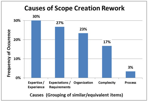

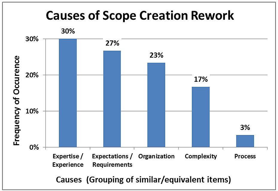

All inputs were recorded on the fishbone diagrams verbatim during the two sessions, and later transferred to a spreadsheet for consolidation and analysis. A reduced set of causes was synthesized by grouping equivalent items together under a broader category, such as expertise. The resulting Pareto chart of the most common causes is shown in figure 7.
Figure 7: Pareto chart of root causes from fishbone diagrams. Click here for larger image.
Data review
Several decisions came from the reviewing the data:
• Changing the overall level of scope-writing expertise within a district so large was impractical, so existing expertise in the chief procurement office had to suffice. This led to modifying the existing source phase to include cross-functional, collaborative sessions as part of the documented process.
• Expectations and requirements would be addressed by publishing best-in-class examples of the scope of goods and services for various classes of items, and instructing the buyers to refer to these when collaborating with end users. Creating standard templates and checklists for novice writers were added to the list of project deliverables.
• Some root causes are not within the scope of the project to address, such as organization issues or complexity of requests, so time and effort should not be wasted on them.

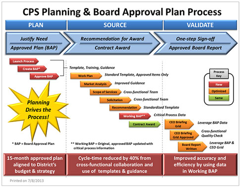

The final design
A high-level description of the redesigned process is shown in figure 8.
Figure 8: Final redesigned procurement process. Click here for larger image.

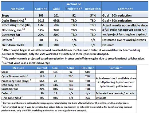

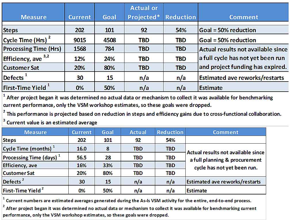

Because the new process was implemented concurrent with the project’s conclusion, no data are yet available for the key process attributes such as cycle time and processing time. One complete planning and procurement cycle, a full fiscal year, is required as the minimum data set to begin quantifying efficiency improvement. However, there were several accomplishments.
Process steps. Procurement process steps were reduced by 54 percent.
Process map. A process map was created that documents the entire process in detail, including activity ownership, relationship, and time frames.
Collaboration. Cross-functional meetings were designed into the process, offering the following advantages:
• Improved leveraging of limited expertise (buyers, attorneys)
• Earlier involvement of legal department
• Reduction of rework cycles stemming from serial review of key steps such as writing the scope of goods and services, and the solicitation document
Documentation. Detailed controlled documents, templates, checklists, and training materials represent a level of integrated process documentation not previously seen at CPS, and will support rollout of the new process and sustain the required culture change.
Metrics. A complete set of process metrics were identified with a phased approach of implementation suggested. The minimum set are those listed in table 1, cycle time and processing time. If properly used, data for both should be available from the new process tools, the working BAP, and the standard work-plan template.
Table 1: Key process attributes—existing vs. new. Click here for larger image.
