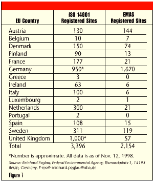

eur1When looking at the numbers of registered sites in the European Union, it is important to remember the size of each country. Some countries have tried to prove they are at the "top of the list" of registrations by comparing the number of registrations to gross domestic product, to population size or to export quantities. As usual, statistics can be used inappropriately.
