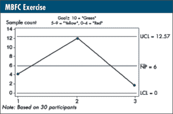

(I conducted a seminar this past week with 30 people, yielding a traffic-light system with ≥10 = green, 5-9 = yellow and <5 = red. We got an undesirable setback pattern of 4 red, 12 green and 2 red. The success rate was: (4 + 12 + 2)/(3 × 30) = 18/90 = 0.2, which resulted in the chart below.
Thus, in a roomful of 30 people, the expected range of double heads is 0-13 and contains red, yellow and green points, even though the 4, 12 and 2 are indistinguishable!)

Every flip presented myriad ways to find "special causes" and actions to "fix" them. Because the chart shows the variation to be common cause, reacting to individual process results and individuals' performances is a no-yield strategy.
Rather than asking, "Why are these numbers different?" try, "Is the process that produced the first result the same as the one that produced the second result, which is the same as the process that produced the third result?" The chart shows this to be true, so any comparisons are invalid (e.g., percent change, projected trend).
You can then ask participants to flip the coin once and count the number of heads. Usually, this value will exceed your calculated upper control limit, and you can emphasize that a different process produced this result. (As in my example above, there's a very good chance that 30 people flipping a coin once will obtain greater than 13 heads.)
Currently, the process is perfectly designed not to meet the goal. Making the goal "tough" and enforcing it through red, yellow and green interpretations distract from the true underlying performance and needed common-cause strategy.
Given three flips, it's impossible to distinguish individual performances, even though they range from 0 to 100 percent.
