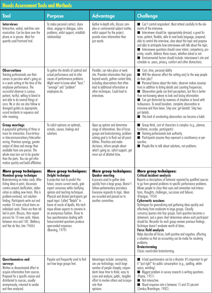

Allison Rossett, Ph.D., professor of educational technology at San Diego State University, refers to needs assessment as “training needs assessment.” She defines it as “the systematic study of a problem or innovation, incorporating data and opinions from varied sources, in order to make effective decisions or recommendations about what should happen next.”
A needs assessment enables you to systematically gather information and data about current employee performance to reveal gaps between that state and the optimal level of performance.
Following are the requirements for conducting a needs assessment:
Select sources to be contacted.
Determine the stages of the NA.
Select and use NA tools.
Create items and/or questions to use in seeking information.
Consider critical incident analysis.
Another possibility is using Robert Mager’s steps for conducting a needs assessment, as follows:
1. Identify the nature of the discrepancy.
2. Determine if it’s important. How much will it cost to fix or to leave alone?
3. Determine whether it’s a genuine skill deficiency.
4. If the deficiency exists, determine whether the employee possessed the skill in the past.
5. Determine if the deficiency is caused by lost or deteriorated skill, whether used frequently or infrequently.
6. Are there simpler solutions than training (e.g., job aids or demonstration)?
7. Does the person have the potential to do the job?
8. If there’s no deficiency, does performance lead to punishment?
9. Does nonperformance lead to reward?
10. Determine whether obstacles prevent the desired performance.
11. Ask yourself, “What should I do now?”
