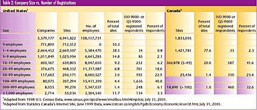

Table 2
Company size
 If ISO 9000 has both universal appeal and universal value, one might imagine that companies of all sizes would seek registration. Although many of us suspected that small companies generally eschew registration, the data contradicts this. Table 2 shows the distribution of registrations by company size compared to the distribution of company sizes in the United States and Canada.
 Although more than half of all U.S. business establishments (i.e., individual sites, even if part of a larger company) employ fewer than 10 people, only about 3 percent of registered companies fall within that size category. Conversely, the 10- to 50-employee range contains about 16 percent of all U.S. companies but 24 percent of all ISO 9000-registered companies. And although only 8 percent of U.S. companies are in the 50- to 999-employee range, two-thirds of all U.S. ISO 9000 registrations belong to such organizations.
 The Big Three automakers might be the primary cause of this phenomenon. As a representative, who wished to remain anonymous, of one of the nation's largest registrars speculated, the ISO 9000 movement in the United States has been largely fueled by the Big Three's mandate for QS-9000 registration of all of their tier-one suppliers -- a great many companies (few of which are mom-and-pop size). These companies, in turn, might require registration of their suppliers, even if it's not directly required.
 "In the auto industry, I can't imagine that there are many first- or second-tier suppliers with fewer than 10 employees," says Radley M. Smith, former member of the Big Three team that developed QS-9000. Further, unless required to do so, most small companies probably won't bother with registration. "This may be a controversial statement, but a company with 10 to 20 people might not need a quality management system like ISO 9000," continues Smith. "These small companies can probably implement an effective QMS without everything that ISO 9000 requires."
 Cost may be one of the biggest factors, suggests Bud Cuthbert, director of U.S. operations for QMI. "These companies are generally new enterprises, and their energy and focus is more likely to be on the maintenance and growth of their business," he says. "Although we have had no direct feedback from small companies on this issue, we believe the primary -- and sometimes sole -- motivation for registration in this category is competition. Larger companies normally have a number of motivations (e.g., quality improvement, competition and customer specifications). And with fewer drivers, the push to become registered is lessened."
 For the most part, the representatives of small companies we interviewed agreed that without some driving force such as a customer requirement or market pressure, they wouldn't have bothered with registration, due to its initial cost and hassle. For smaller companies, the issue against registration seems to be labor resources.

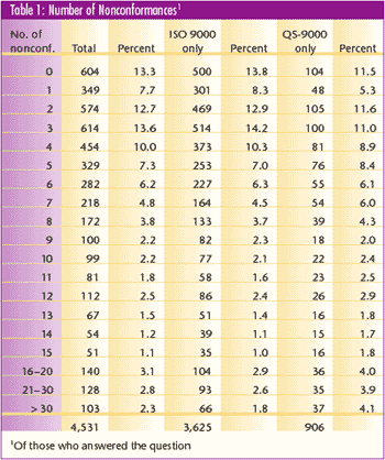

 To measure this, we asked respondents to tell us how many nonconformances they received on their first audit. We then ran a correlation on company size vs. number of nonconformances. The result? There is no correlation.
 Smith isn't surprised. "What matters is not the size of the company but the quality of its management," he states, echoing a key registration success factor that registrars and consultants alike have been hammering home: If management fully supports the effort, there should be few nonconformances. Management is then responsible for ensuring that the necessary brainpower and resources are used when implementing ISO 9000 and ironing out any nonconformances.
Table 1
 We were surprised at the large number of companies (about 13%) that reported receiving zero nonconformances and the number reporting 15 or more nonconformances (see Table 1). However, regarding the zero nonconformances, Smith points out that automotive suppliers have a lot at stake. Faced with being cut off as Big Three automotive suppliers, those companies might work extra hard to have their systems run perfectly. Although at face value this makes sense, comparisons between the percentage of nonconformances to
ISO 9000 registered and QS-9000 registered companies showed little difference.
