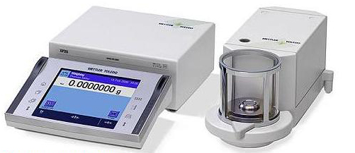

(Mettler-Toledo Inc.: Columbus, OH) -- Mettler Toledo introduces a line of ultramicrobalances and microbalances to the current Excellence Plus and Excellence lines of analytical balances. The XP6U and XP2U ultramicrobalances and the XP6 microbalance with up to 6 g capacity and 0.1 μg or 1 μg readability, provide measurement accuracy, user friendliness, and quality standards. The Excellence XS3DU microbalance offers fundamental functionality with good weighing performance in a 800 mg fine range, with a 1 μg readability.
The Mettler Toledo XP6U is an ultramicrobalance with 61-million digit resolution. The Mettler Toledo XP2U is an innovative ultramicrobalance, providing optimal weighing performance, user friendliness, and quality standards. The XP2U ultramicrobalance has a high resolution of 21 million digits. Combined with all other XP related characteristics, such as colored touch-screen display, customized screen programming, intelligent user guidance, and hands-free infrared draft shield, these microbalances and ultramicrobalances are accurate and flexible in the use of tare vessels.
The Mettler Toledo XS3DU is the first microbalance to be offered in the Excellence product line. It is designed to boost efficiency and reproducibility of work in basic research labs or academic institutions.
Mettler Toledo also provides tailored options and accessories; the microweighing table enhances ergonomics for long-term weighing tasks; the balance-driven antistatic U-ionizer helps achieve more precise weighing results; and the new CarePac with up to three calibrated test weights, ensures traceability of project results.
