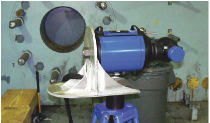

For this application, technicians needed to take measurements straight down from the top bore. This is not physically possible in the standard or vertical orientation of the laser tracker—these measurements would require mounting the laser tracker horizontally. Oglethorpe designed and constructed a custom adapter made out of aircraft aluminum, and worked with FARO technicians to modify and download different software to slow down the speed of the gyros. Eventually they were successful in attaining the correct balance of speed and inertia to use the laser tracker in the horizontal position. This saved numerous man hours during the initial line bore checks. After the line boring was complete, they again measured the bores to ensure they maintained the specified tolerances.
Laser tracker and adapter plate for horizontal operation
