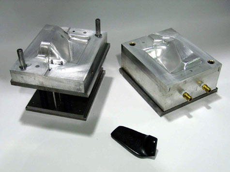

Once the polygon model was finalized, the software was used to automatically generate a NURBS surface model. The model was imported into Parametric Technology’s Pro/ENGINEER software, where the mechanical features were added and an injection mold tool was built. IGES files of the tool components were exported to Surfware’s Surfcam system to manufacture the injection mold with a CNC machine.
IGES files of the tool components were exported to Surfcam software to manufacture the injection mold with a CNC machine.
In the final step, the aluminum mold was mounted on a JSW injection-molding machine, and injected with acetal to make the blade. ADC used Geomagic Qualify computer-aided inspection software to automatically align and compare measurement data from cross-sections of the physical part with the digital model, verifying that the molded blade matched the original design.

Using the injection-mold process, the cost for American Blimp to make each fan blade is slightly more than $5, compared to about $50 when the parts were manufactured directly on a computer numerical controlled machine. The process allows the blades to be molded from glass-filled acetal, which has better fatigue and UV resistance, as well as high stiffness, low warpage, and better resistance to deformities.
