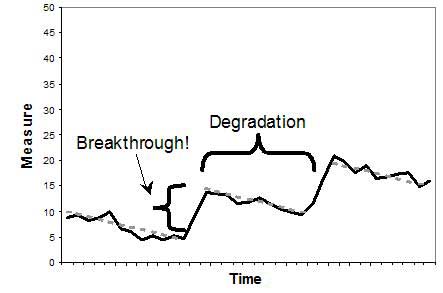

How does daily management conflict with Six Sigma? It doesn’t. It meshes neatly with it. If you look at who does the work, you see that there’s little overlap, and if you look how the two interface, they become interlocking parts of the whole. People assume that with Six Sigma, they will see step-change improvements in their business:
But in reality, in the absence of a good daily management system, you get an ongoing degradation through time:
Therefore, all those benefits from the breakthroughs you Black Belts have achieved erode away due to increasing inefficiencies in all the other processes in your business. Then you are living what Lewis Carroll’s Red Queen said: “Now, here, you see, it takes all the running you can do, to keep in the same place. If you want to get somewhere else, you must run at least twice as fast as that!”
