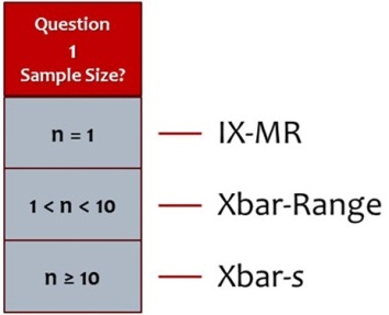

The sample size is the number of measurement values, for a given test feature, to be gathered to represent a single “snapshot of time.” For example, if weights are taken from three consecutive filled bottles every 30 minutes, the sample size is three and the sampling interval is 30 minutes. The sample size does not represent the number of plot points on a chart. The common symbol used for sample size is n. There are three sample size considerations:
• Sample sizes of 1 (n = 1)
• Sample sizes between 2 and 9 (2 ≤ n ≤ 9)
• Sample sizes of 10 or larger (n ≥ 10)
When sample sizes are 1, the IX-MR (individual X and moving range) chart is used. For sample sizes of 2 through 9, the Xbar-range chart is used. For sample sizes of 10 or greater, the Xbar-Sigma chart is used. These are the three core variables control charts. Most all other variables charting techniques are rooted in one of these three core charts.
