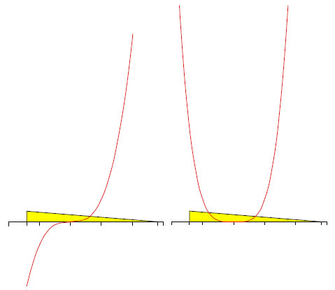

Since this is a standardized distribution, the standardized form for the random variable reduces down to simply [x]. Thus, the formulas for the skewness and kurtosis parameters reduce to the following:
Thus, we see that in this case, the skewness is the integral of the product of the cubic curve and the density function, while the kurtosis is the integral of the product between the quartic curve and the density function. Figure 2 shows the density function along with the cubic and quartic curves. Figures 3 and 4 show the resulting product curves.
Figure 2: Cubic and Quartic Curves with f(x)

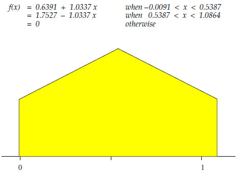

The reason that these distributions will only provide a first order approximation is due to the fact that the skewness and kurtosis only characterize the tails of the distribution. This is why it is fallacious to think that two distributions having the same mean, standard deviation, skewness, and kurtosis will have exactly the same shape. A second, related fallacy is that a distribution with a skewness parameter of zero will be symmetric. That these are indeed fallacies will be illustrated by the following examples.
Figure 8 shows a simple symmetric probability model characterized by the density function, f(x) where:
Figure 8: A Simple Symmetric Probability Density Function
The probability model in figure 8 has a mean of 0.5387, a standard deviation of 0.2907, a skewness of 0.000, and a kurtosis of 2.000. The symmetry of this distribution requires a skewness of zero, and the short tails result in a small value for kurtosis.
