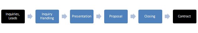

So are you ready to include your outside sales processes in your product realization processes? The first thing you need to do is map your processes. Here is a good example of what a simple sales process may look like. The inputs and the outputs are depicted in black. The outside sales process steps are depicted in blue. The arrows show the sequence and interaction. In this case we are assuming the process happens in a straight line.
The benefits of a straight line is that you are forcing the process to go a certain way, and although adjustments may be made if you get the contract after the inquiry handling step, the idea of mapping the process is that you do not submit a proposal unless you have conducted a presentation—and not after the first inquiry handling step.

Inquiry handling. Here you can explain what you expect to be said upon receipt of a call or how you expect to answer an e-mail. Obviously every case is different and every customer is different, however having some guidelines will help even the receptionist become a good sales call handler. Here are a couple of things you can also prepare:
Presentation. Depending on what kind of sales you do, presentation will most of the time work to your advantage. So this step should allow for either face-to-face presentations or online presentations. In either case you can let each sales person do some customization, however, having a consistent and basic presentation is key to ensuring everyone will show what is considered important.
Proposal. This step should provides guidelines for providing a good proposal. Of course, templates will also be necessary to ensure that your sales team looks professional. Even if you submit proposals as part of an e-mail, having a template will help maintain consistency.
Closing. Follow-up in the form of e-mails, phone calls, and so forth could be covered in this step. You could also implement logs to keep track of follow-ups. Of course if you own a sales software package, then the software should help you keep track of the follow-up steps.
