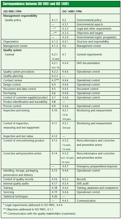

Processes for obtaining ISO 14001 registration closely resemble those involved with ISO 9000 and related quality standards. The differences lie mainly in what the standard requires rather than the registration process.
 ISO 14001 contains six main clauses:
Qdbullet Clause 4.1--General Requirements.
Qdbullet Clause 4.2--Environmental Policy. This will be appropriate to the business and its environmental impacts. It states the organization's commitment to legislative/regulatory compliance plus continual improvement and pollution prevention. The policy will provide for environmental objectives and targets, be used by employees and be available to the public.
Qdbullet Clause 4.3--Planning. This requires organizations to identify their environmental aspects, determine which ones have significant impact and ensure that they establish, and have access to, relevant environmental legislation/regulation. Organizations should then produce improvement objectives and targets, along with a process for achieving them.
Qdbullet Clause 4.4--Implementation and Operation. This provides resources for personnel, defines who does what, identifies training needs, communicates effectively both internally and externally, and documents and controls the management system. Organizations should exert effective control over the operational activities relevant to their significant environmental impacts, and consider accidental or emergency situations with associated environmental impacts.
Qdbullet Clause 4.5--Checking and Corrective Action. Organizations should: use accurate measurement methods and regularly ensure that progress toward objectives and targets is on track; periodically ensure continued legislative compliance; take action commensurate with the problem where nonconformance is identified; and record the operation of their environmental management system, and conduct audits to prove conformity with their intentions.
Qdbullet Clause 4.6--Management Review. Top management must ensure that the system continues to be suitable, adequate and effective, and should make changes or adjustments in the light of experience.

Adding ISO 14001 to ISO 9000
EMS implementation can seem like a time-consuming and costly undertaking. However, organizations that have implemented ISO 9000 have a distinct advantage over those unfamiliar with the process. They have a sound understanding of the process, specifically the common elements (document control, calibration, internal audit, management review, etc.) between the two standards. Depending on the company and the situation, 25 percent to 50 percent of ISO 14001 requirements may already be in place with ISO 9000.
When performing the original gap analysis--mapping out the elements an organization already conforms to and discovering what it needs according to the standard--an ISO 9000-registered organization will find less holes and overlapping requirements. With this increased knowledge base of the common elements, the length of the registration process may be significantly reduced, and the benefits may be realized much earlier.
Many organizations seek one business management system. Likewise, ISO 9000 implementation teams have infused disciplined processes. ISO 14000 implementation teams need to understand the organization's business processes and subprocesses in order to determine process inputs and outputs. This is a critical part of the planning to accurately and completely identify the organization's aspects and impacts on the environment. This analysis forms the baseline for the organization to set objectives and targets against some of those significant impacts in order to measurably improve the organization's environmental performance.
Most third-party assessors encourage organizations to integrate their EMS with their other management systems, such as ISO 9000. The ISO 14001 standard's requirements are very much like those for ISO 9000. By integrating the quality management systems and EMSs, and with a little fine-tuning, many of the same procedures can be utilized for both systems, and organizations will simply need to focus on ISO 14001's objective elements. This will result in less documentation and lower implementation costs. Additionally, integrating the two systems will reduce the time internal and external auditors must take to assess the organization against ISO 14001.
By expanding the scope of the management system to include environmental management, the quality professionals and, more importantly, their organizations, will have already been through the cultural changes that often come with implementing an international quality standard. They will better understand the assessment and registration process. With a firm grasp on how the system works, the details it encompasses and the changes that ensue, organizations can more easily expand the business system to manage their environmental activities using ISO 14001 as a guide.
