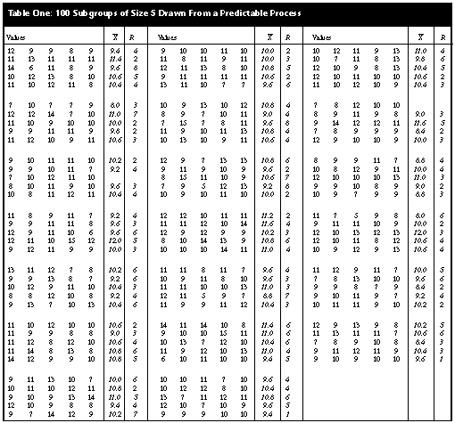

Capability ratios are statistics. All statistics will vary from sample to sample, even when the underlying process doesn't change. We will use the data in Table 1 to illustrate the manner in which capability ratios vary over time.

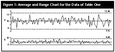

The data in Table 1 were obtained using a quincunx (also known as a bead board). Since no changes were made in the settings of the bead board while these 500 data were collected, these data should be taken as being typical of data from a process that displays a reasonable degree of statistical control. And that is exactly what we see in Figure 1a chart that reveals a predictable process.
For the data of Table 1, the grand average is 10.084, and the average range is 4.11. Thus, the limits for an average and range chart for these data would be:
For subgroup averages:
X= ± A2 R-  =  10.084  ±  (0.577)(4.11) = 7.71 to 12.46
For subgroup ranges:
D4 R-  =  (2.114)(4.11)  =  8.69
As may be seen in Figure 1, the data of Table 1 do, indeed, display a reasonable degree of statistical control. There are no indications of anything other than routine, common-cause variation.
Based on these data, the natural process limits would be computed as:
X=  ± 3R-/d2 =  10.084  ±  3 (1.767)  =  4.78 to 15.39
meaning that we should expect process values that range from 5 to 15. If the specification limits for this process are 3 to 17, then we will have a process in the ideal state -- both predictable and conforming.

The calculations above are based on 500 data, and we seldom wait until we have so much data to compute the capability ratios. In most cases, capabilities are computed occasionally, or periodically, using 50 or fewer values. So we shall divide our 100 subgroups into blocks of 10 subgroups each and compute the Cpk value for each block. Ten subgroups of size 5 will yield estimates of dispersion with about 36 degrees of freedom, which is commonly considered to be satisfactory.
Subgroups 1 to 10: Grand average = 10.08,
average range = 4.0, and Sigma(X) = 4.0/2.326  =  1.720

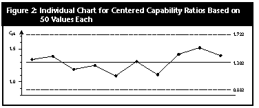

    Of course, the real answer is that we are not slipping. The process was not getting worse, nor was it getting better. But our statistics were changing from block to block even though the process remained the same, and these changes were reflected in the centered capability ratio values computed. If we placed these 10 centered capability ratios on an XmR chart, we would get Figure 2.
Figure 2 shows that the routine amount of variation in capability ratios, based upon 50 values each, will allow them to go as low as 0.88 or as high as 1.72, while the process is unchanging with an average capability ratio of 1.30.
     Before you can interpret a single capability ratio, based upon 50 data, to mean that this process capability has changed from the value of 1.30, the single ratio would have to fall below 0.88 or it would have to go above 1.72! First, you must detect a difference before you can meaningfully estimate that difference, and only then can you assess the practical importance of that difference. To ignore this sequence is to risk interpreting noise as if it were a signal, with the result that your interpretation will turn out to be meaningless and your actions inappropriate.
So how can you make sense of the capability ratios? Put them on a control chart. If this chart is out of control, you can be sure that your process is also out of control. However, the converse is not true -- your process can be out of control and still yield a control chart for capability ratios that is in control.
    To allow for the inherent variation in any statistic is the beginning of numerical literacy. To fail to do so is the primary symptom of numerical illiteracy. You will reveal the group to which you belong by the way you interpret capability ratios.
