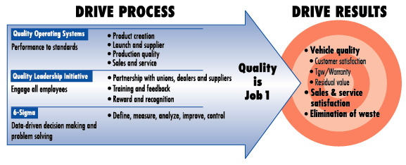

QD: Give a general overview of Ford's quality program. How does Consumer Driven 6-Sigma fit into that?
Goeser: We stress three components in our "Quality is Job 1" strategy: Quality Operating Systems to define our standards and processes, Quality Leadership Initiative to engage all of our employees and Consumer Driven 6-Sigma as our primary data-driven decision process.
