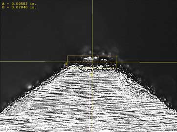

 People are frequently surprised by how bad their part features look when viewed at the magnifications utilized by VCMMs. Unless manufacturing and inspection are performed in special cleanroom conditions, part contamination is always present. The dust particles are often larger than the whole error tolerance. Dust, burrs, flash, rough surface texture and other surface flaws will all increase random error and nonrepeatability in the inspection process. Figure 1 shows the edge of a mold machined by electrical discharge machining (EDM).
Figure 1: Close-Up of a Mold Edge MAchined by Electrical Discharge Machining
The tip is designed to have a small radius, but in this image the manufacturing process has burned away the tip. There is no way to reliably measure this feature as a radius. The typical surface roughness range on this part was 0.002 in.
