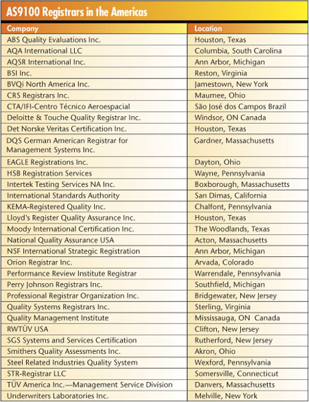

In the Americas, 32 registrars are approved for AS9100. They are listed in the table below.
