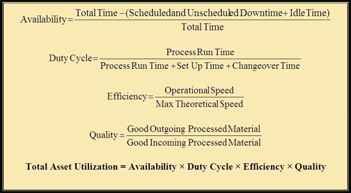

Well, what if that extra stress that product A causes to our machines is actually associated with more unexpected downtime? What if when switching our line over to a different product it takes longer to set it up to run product A than product B? What if we have to run the line more slowly when making product A in order to maintain quality? What if we end up making more scrap for product A than product B? What I am really asking is, “What opportunities do we lose when we run product A?”
To answer this, I need a measure that can tell me on some relative scale what I’m missing by running product A.
One method is to quantify the effectiveness of a process against an absolute, and then use relative effects of different choices to understand the opportunity cost. I have found that total asset utilization (TAU) is straightforward and helpful for this. TAU separates the effective use of time into two components—availability and duty cycle, and the effective use of the process into two components—efficiency and yield. These four factors are dimensionless ratios, so by multiplying them together you end up with a measure of how well you use the process to make something you can sell. Note that total time is 365 days a year, 24 hours a day.
Figure 1 - Example components of total asset utilization
Let’s make it simple and say we find the following:
Product A
Product B
Availability 80% 80%
Duty cycle 90%90%
Efficiency40% 80%
Quality80% 80%
TAU 23.04%46.08%
Price/unit $100 $25
Profit /unit $1.00$0.75
It turns out upon investigation that everything is the same, except I have to run the process more slowly to make product A to maintain quality. Note that the profit per unit includes the cost of the extra time to run it on the line. (You can see how if product A had higher scrap, more changeover time or higher downtime, the TAU would be lower. The profit per unit would also be lower, but let’s keep it simple for now.)
Now (finally!) I have a way to compare the tradeoff between products A and B. If I choose to run the line for an hour, I can make and pass 100 units of product A or I could make and pass 200 units of product B (the TAU for A is half that of B).
